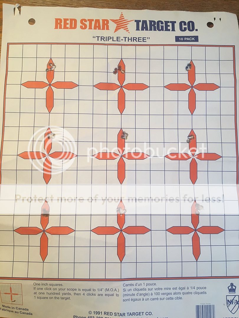

Our club range is 100 meters, not 100 yards so a 10% adjustment downward could be made. The 5 shot groups were shot during load development, with two different bullets and 7 different loads. You aren't going to make me measure them are you? Top row is 42, 42.5, and 43 grains of Varget under pulled down 215 gr Hybrids because that's all I had left.
2nd row is 44, 44, and 42 grains of Varget under the 210 VLD
Bottom row is 41, 42 and 43 grains of Varget.

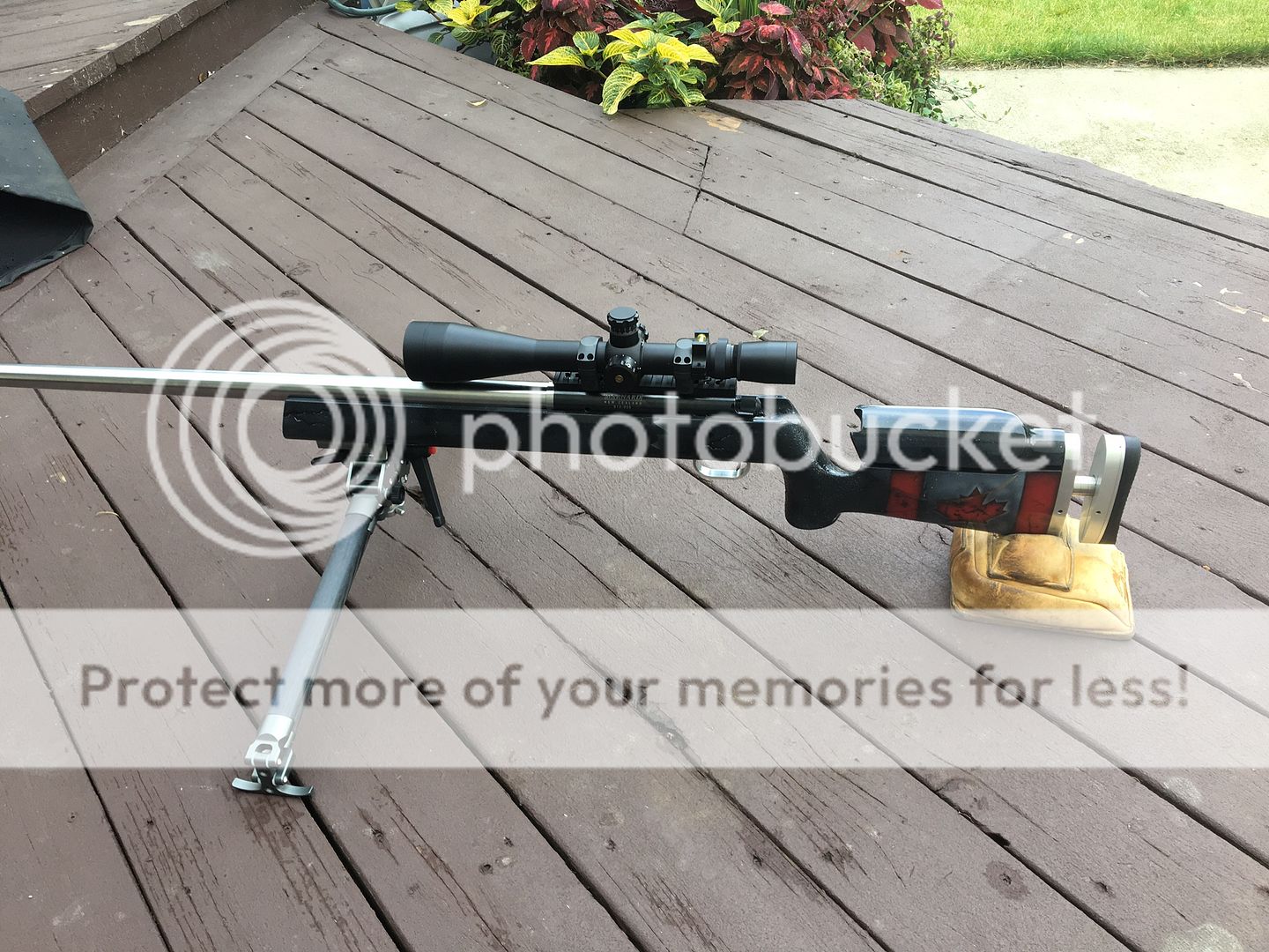

Rifle is my future FTR rig, .308 throated long, Barnard single shot S action, Robertson composite BC-1, 31" Bartlien barrel. Its got a 8.5-25 Mark 4 8.5-25 X 50mm. Shot it from a Caldwell and protector rear. Nothing fancy there. Sort of concluded that 100 meter testing was a waste of time in this case.
