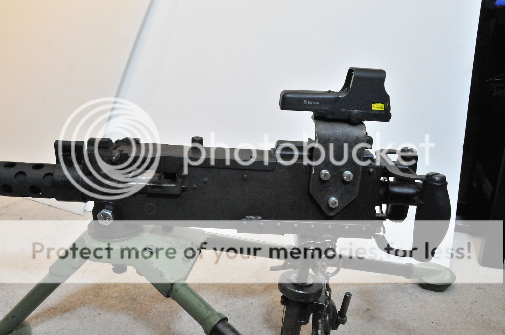

Best of all, I sighted it in with the EOTech 512 & custom mount (thanks dude, you know who you are)...
Two guys were at the range & they couldn't believe the group I shot! Here it is... First shot was low, so I adjusted the scope.
And here is the gun that I shot it with!
So... I do believe I will have a good chance next year of taking a deer with this, using a 5 round belt of course, as per the game laws.

I have two 250 round belts. Today I probably fired 75 to 100 rounds??? I was there to (1) sight in the gun with the new optic, & (2) see if it ran on cloth belts & IT DOES!!! :ar15:

And the 1moa dot was awesome! Plus, when you really started YANKING on the trigger, the 65moa circle came into use & kept you roughly on target, ha ha!

P.S. I forgot to say the group was shot at 100 meters...
they will allmost allways run the cloth (as long as the rnds are in correctly) fine its the links that jam up many of them mine sometimes runs links all day when the gun feels like it usually i run cloth through

Nice groups Jay!.
The Eotech is the perfect optic for this gun.
What you need now is a set of spade grips. Once you try them, you will never go back to the pistol grip.

I confess. I made the sight mount. Made one for Jay, another for myself. Two more are in the works, waiting to get some 1/4-28 Allen head screws.
The main bracket is made from a piece of 4x4x1/4 6061 aluminum angle. It is drilled and tapped for a Weaver scope base. The one on Jay's was for an octagon barrelled muzzleloader, with another slot milled in it. I used a slightly shortened base for a 336 Marlin on mine. I've got a 2 1/2X pistol scope mounted. The long eye relief is a good feature. A piece of Pic. rail could be used, as well. The Weavers were available, so I used them.
There is a catch - the mount has to be short, so that the top cover and the backplate can be removed with the base on the gun. A sight like the Eotech is ideal, because it is short, at both ends. With the compact scope, the scope must be removed before the backplate can be removed, although the top cover can be opened with the scope in place.
Thanks tiriaq, thank you VERY much! The mount worked AWESOME & I will do my best to get a deer next year with it!!!
It was even 'on paper' at 25, just had to adjust up a bit & left a bit... Then the first round at 100 hit low, so I adjusted up & shot the group you see on the CanadaAmmo target...
The gun is a hoot to shoot with the EOTech! It really is!
