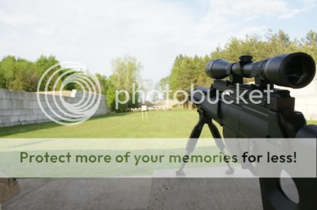

So here is my Baby! My first black rifle, definitely not the last. I bought this rifle off the EE in February; I might add I made a killer deal on it. Rifle arrived like new.
Rifle
Very solid, no movement, I love it! Just like everyone said I would.

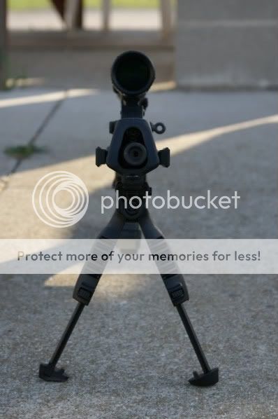

I didn’t like the HK factory Bi-pod, or the price of it, so I purchased the FAB T-Pod off eBay. Its a little big, and a little heavy, but I'm pretty happy with it. With one press of a button I can slide it forward on the rail, and use it as a bi-pod, or slide it back and use it as a vertical grip. I was interested in the GPS02 Grip Pod, but decided on this one instead. Maybe I'll get the other one when I get an AR15.
