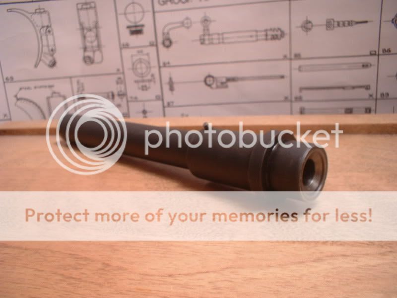

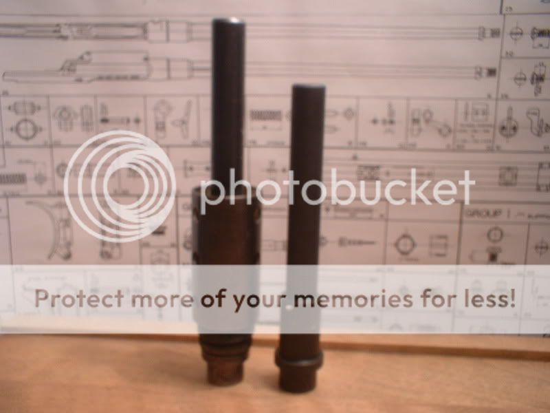

I don't know about whether or not it would end up having to go to the lab because of the short barrel, but I decided to give shortening a cut barrel a try. Some of the barrels (but not all) use a sleeve at the chamber end for the larger portions of the barrel. This way they could just use 3/4" barrel stock for the barrels, and pin the barrel to the sleeve with the same pin that retains the barrel nut. The third barrel I tried had the sleeve, so I knocked out the barrel from the sleeve on a press. I cut both ends of the barrel clean, and re-inserted it into the now welded sleeve (it was cut at the chamber area as well). A quick crowning of the barrel on the lathe, along with the neccessary rechambering and chamfering of the chamber end of the barrel, and it was done. I gave it a quick sandblast and cold blue and it looks good. Total material lost was about 1-1/8 inches, so now the barrel is only 6-1/2 long, instead of 7-5/8.
I have about a half dozen scrap barrels in similar shape. This is a way to recycle some stock that would otherwise be useless.
I did use a piece of one to make a new barrel for a prohib 12.6 a while back. I'll post some photos of that project in it's own thread when the project has finished.
If appearance were an issue, it would be easy enough to install a sleeve at the muzzle end to increase the apparent over all length.
This is a vey good idea stencollector. I have some scrap 9mm carbine barrel which was too small in diameter for my SAS project. But using your idea and turning a short chamber section out of 4140 and then turning down the carbine barrle to fit, would give me a carbine length sten barrel for free.
A couple of quick questions; what diameter did you turn the barrel down to to fit in the chamber section?
Did you use a straight reamer for the chamber? I think the tapered 9mm reamer are unnecessary for a closed bolt design?
The barrel remains it's usual diameter of 3/4 an inch. It is not stepped, but is a tight fit onto the stepped portion. The pin that holds the barrel nut on also goes through the barrel portion of the combination.
I used a straight reamer. Combined with my tailstock being a couple thou out, it formed a tapered chamber nearly identical to the original sten chamber.
Not sure how much the taper matters on the closed bolt, but I think it helps the feeding.
