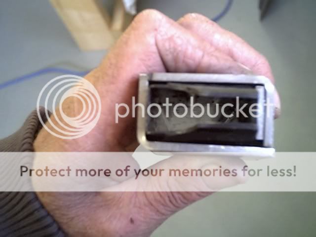

I used those jigs - top notch jigs, they are
Spencer's method works well, but the problem with using two sections is that you have to start oversize b/c the box shrinks once you weld it on the opposing corners, and then you have to file the heck out of the inside to fit the mag. Ask me how I know this
If you start with four plates and build up the corners with weld, it doesn;t shring as much - not sure why - and there is less hand-fitting required.
The brits often made their mag wells by bending a complete channel and only welding one corner. This is likely the BEST method, but requires a specialized metal brake that I don't and won't have access to - ever.
