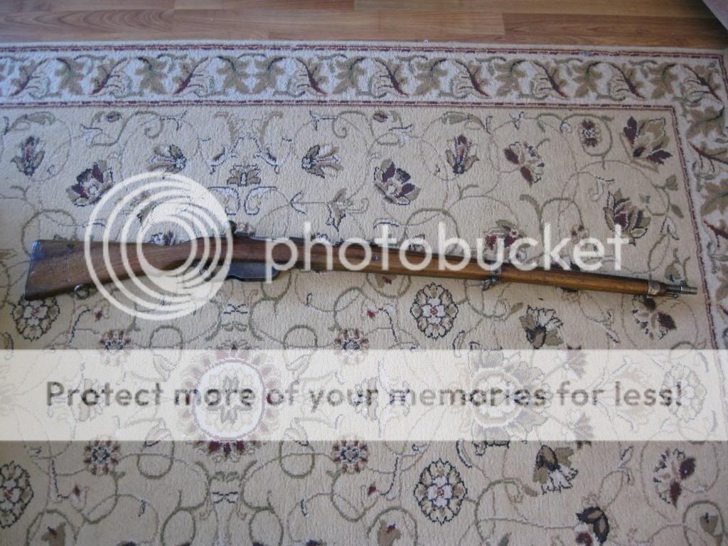

here is a pic of my M95 Steyr rifles. they are my favorite bolt action military gun. when it comes to the short rifles no 2 are the same. I find them very interesting.
I put a second pic of the stock of one of the guns that was refurbished in Bulgaria. it looks like it some how got lucky and was remated with its original stock. they crossed off the old number and restamped it with the same number? its all matching.
I am hoping more people get into these fantastic and well built rifles.
Most collectors don't realize how much action these rifles have seen. They were used above the tree line on high mountain European Alps glaciers, in the forests and in the trenches. Very reliable and accurate rifles that many say Ross copied to build his rifles.
You have rifle, you have ex-carbine, you short rifles made of long rifle, you need to get ex-stutzen :)
