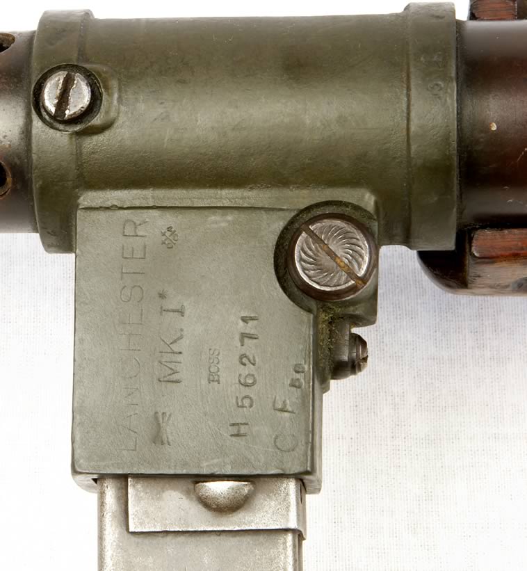

I just saw your thread regarding the finish on your Lanchester.
I am glad to hear that you decided against removing the finish off the magazine housing as I suspect that it is the correct original finish.
I have also seen photos of the polished brass looking housings and I had the same questions that you have.
I own a very nice Lanchester Mk 1* and the whole gun has a greenish/gray finish including the barrel jacket.
Photographing the accurate color finish on some guns is very difficult.
I have attached some photos to try and provide a sense of the finish on my gun.
David
