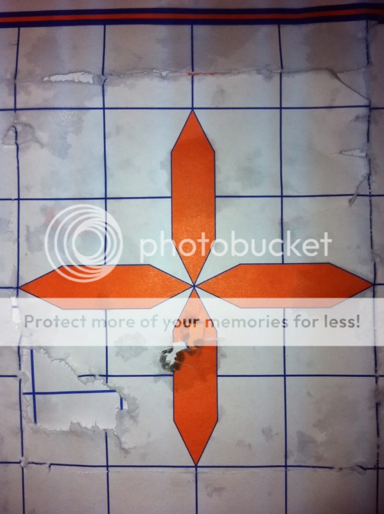

I own the TRG-22 and have a variety of great loads through it. Not picky to tune. I frequent this rifle long range anywhere from 800m to warm up to 1000m to hit, 600m to goof around with and load develop at 200 meters prone off a bag with it...NEVER A BENCH in my shooting. Something to do with being in the CF i guess.Constant 0.5 MOA even on my bad day. I haven't benched a gun for load development in a long time. I'll post some pictures to follow as talk is cheap in the shooting world.

I've seen many TRGs, a variety of AWs and some Coyotes and 1 Nemesis. Overall scoreboard in my opinion goes to the TRG, i've seen many TRGs shoot lights out. 6 friends/people i know shoot them and all are the same. I went with the TRG because my prior sweet load shot 1 ragged hole through 3 different rifles in one day. I sent 5 rds down one 20 incher and ten rounds down 2 different 26 inchers. All three of them had the same group. I was sold.Much less than the others mentioned and every bit as accurate as the shooter. By no means am i world class shot, i am a very good shot don't mind me saying.

Best 5 Shot Group Prone Off A Bag @ 200 Meters.
Average 5 Shot Group Prone Off A Bag @ 200 Meters.
Tomochan can support these photos as I may have taken a 5 dollar bill off him as he has won a few friendly wagers off of me.See you guys at the TacMatch.... Training Schedule pending.
R-700 is to bad you had a bad first impression of the Nemesis, surely a technical explanation, for myself, a few minor champering hiccups the first time i mounted it in my house, its been perfection since even with my mega R-17 208 Match load the bolt is easy and silky smooth, the Nemesis is now the reigning kind of all my rifles, it's performance make that a well deserve title... My 0.02. JP.
I am happy to confirm the veracity of R700's remarks and photos. As I have said before on this forum, I have yet to see a TRG that won't shoot 1/2 MOA with proper ammo. IMO the PGW Coyote is a shade more accurate than the TRG but there is a cost differential. In terms of rifles costing $3K or so I cannot think of a better buy than the TRG. If the Nemesis cost is in the $5k zone the question one should ask is it worth it when for that money I can but a TRG - a rifle of proven quality - and some relatively good glass or a PGW which is, again, a rifle of proven quality and resale value.
