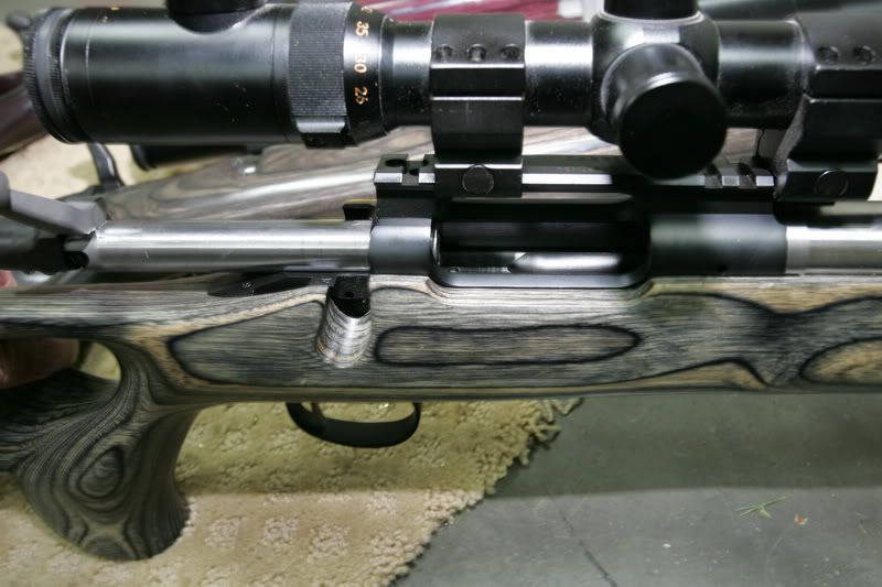

Only took 12 rounds to the range to do my break in, all culled brass (some were above/below standard weight and some were neck turned too much).
Boresighted it at 300m on the steel Pig, let the first shot go......PONG......rung the pig...LOL
9th, 10th, 11th and 12th round out of the rifle. Only had 4 rounds left to print a group with so I went for it.

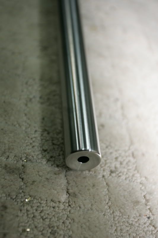

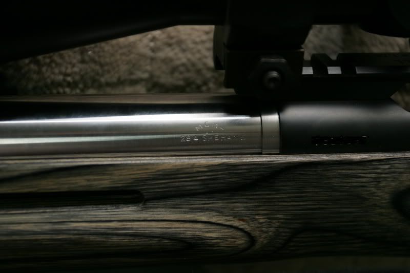

Barrel is finished at 30"
Berger 180 VLD's Jammed
Lapua 6.5-284 Brass necked up and neck turned
51gr Reloader 17
No load dev...just went with what I knew would be safe for fire forming and break in.
Chrony to come tomorrow on this particular load then I can work from there.
Shot at 100m
.607-.284 = .323

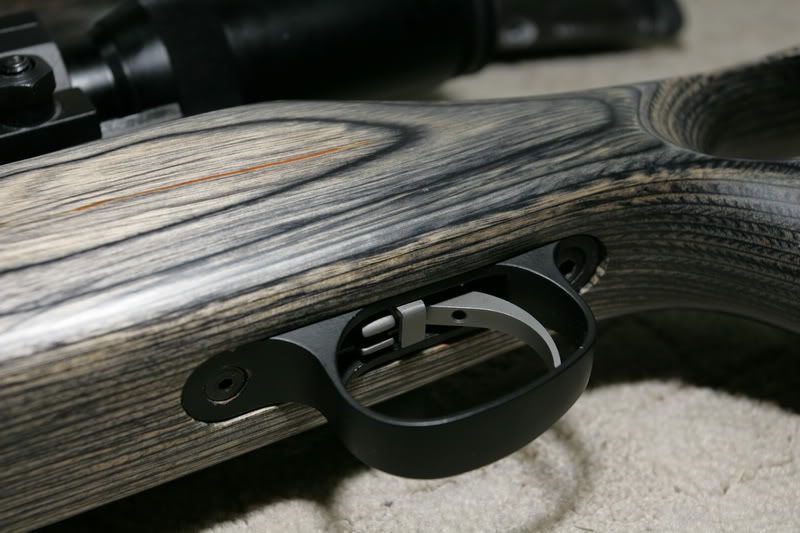

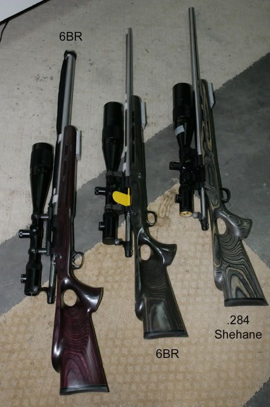

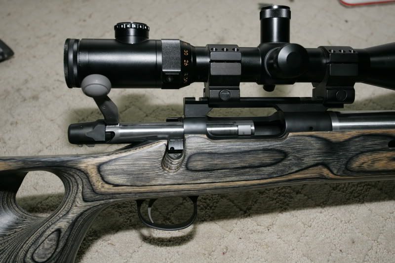

Just built my LR F-Class rig.
XR-100 Action and Stock - $700
PTG Bolt/Firing Pin assembly - $300
Jewell Trigger - $200
Krieger Barrel - $490
Farrel Base - $100
Smith Work - $510 (Includes truing the action as well as stock work and barrel chamber/install)
______________________________
Total - $2300 (Taxes Inc)
