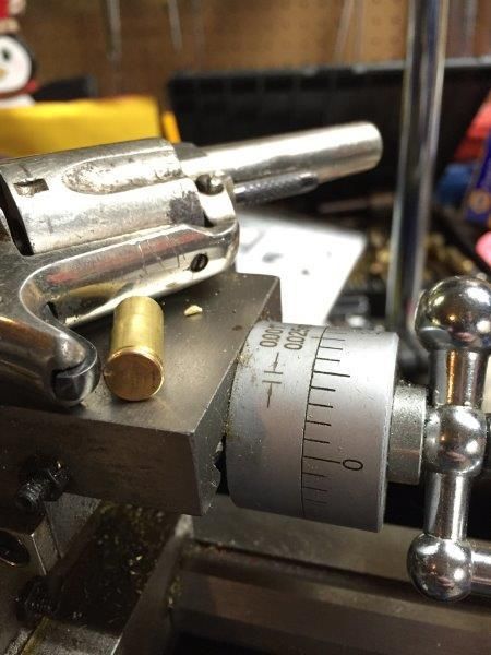

Well my brass tube showed up today so as soon as I get a couple hours of free time ill make up a dozen or so rounds and hopefully Ill let you guys know how they shoot this weekend
I've just been using a tubing cutter, same as the steel tube. Im interested to see how well I can form a rim on the brass tube
OK, maybe I just need a smaller one - mine tends to crimp the cut a bit but a lot with this soft brass tubing. I'll bet forming the rim won't be too difficult as long as you're forming against a good base, the brass I've got seems pretty malleable. Will be interested to see how you make out.

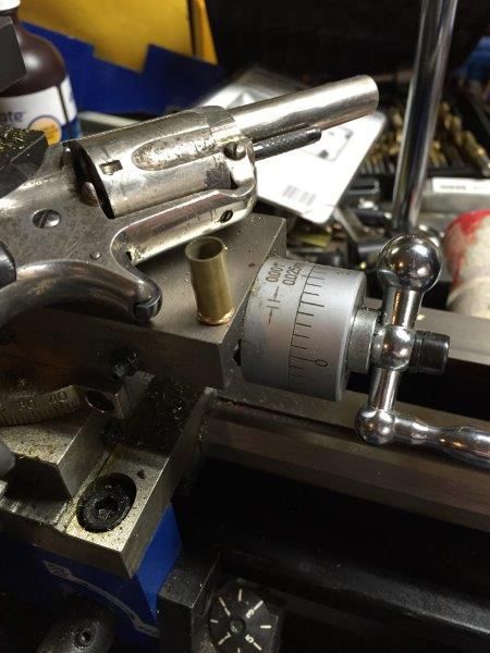

I gave some "tube cartridges" a try using .27 cal Ramsets (powder dumped), some FFFg and a round ball, no flange on the tube (5/16" drawn brass from the hobby shop). In my particular revolver, I found that the headspace is so thin I had to thin my precious .32 Short Colt brass to a point where it was non-existent and the brass often non-reuseable, so this actually worked GREAT. The cylinder rotated perfectly and everything looks pretty good.
As I noted, and others have experienced, the norm is a little more rim thickness so this isn't typical; my Stevens Favorite for example swallows the .32 SC brass with the .27 and meat to spare, shells are easily reloadable (tight action I may add, no lever droop, no slop).
Fired case:
Firing pin had good contact on the .27 rim.

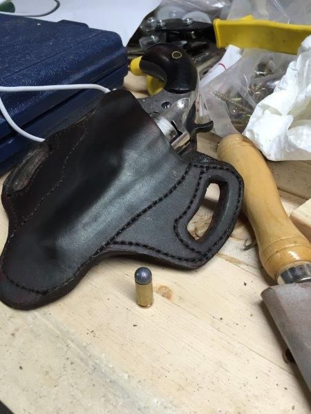

I havent had a chance to try any of the brass tube yet, but I just loaded up about 40 of the steel rimmed cases and ill be doing a little shooting tomorrow so that will be fun
Also what kind of holster is that? I got mine from dixie but I like that one a little better. Id rather find a flap holster, but they sont seem to exist in this size

Well I finally had a chance to try out some brass tube and it definitely works better than the steel but I have to make a couple changes to my process. Firstly, the brass definitely has to be appealed, as im getting some stress cracks when im forming the rim, and I need a better method of holding them while im forming the rim. Other than that they worked great and fired fine with blanks. Ill have a shooting and reloading report next weekend when I head out the the farm. I put a picture of the brass ones on my photobucket but Im still not quite sure how to post a link on this phone.

On another note: How are you finding getting a boolit or ball in there (the brass tubing)? I can get a ball to stay in the mouth but not well. A heeled boolit I managed to seat in there but it wasn't happy about it. I was worried about airspace with BP for this reason so I loaded with smokeless (carefully researched). Works fine. I'm wondering about reaming the mouth somehow, not having much luck trying to bell it; it seems thicker than cartridge brass?
