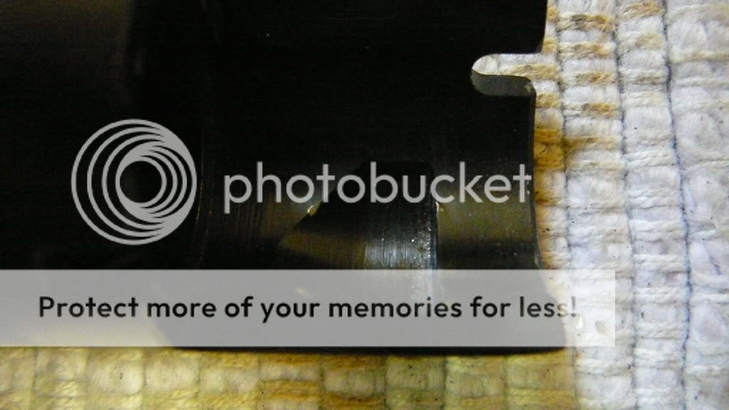

My first shotgun was an 870 supermag. 50rds and the locking lugs started to peen on back.(yes the end cap was on tight) Nice heat treat there remmy :cool:. Had all the issues with FTE (rough chamber) no matter what loads went through it.
Take a look at the pics of my first and last 870.
Im done with Remington now, thats 2 guns(bad experience with a 572) that never should have followed me home. Should have took the hint the first time.
