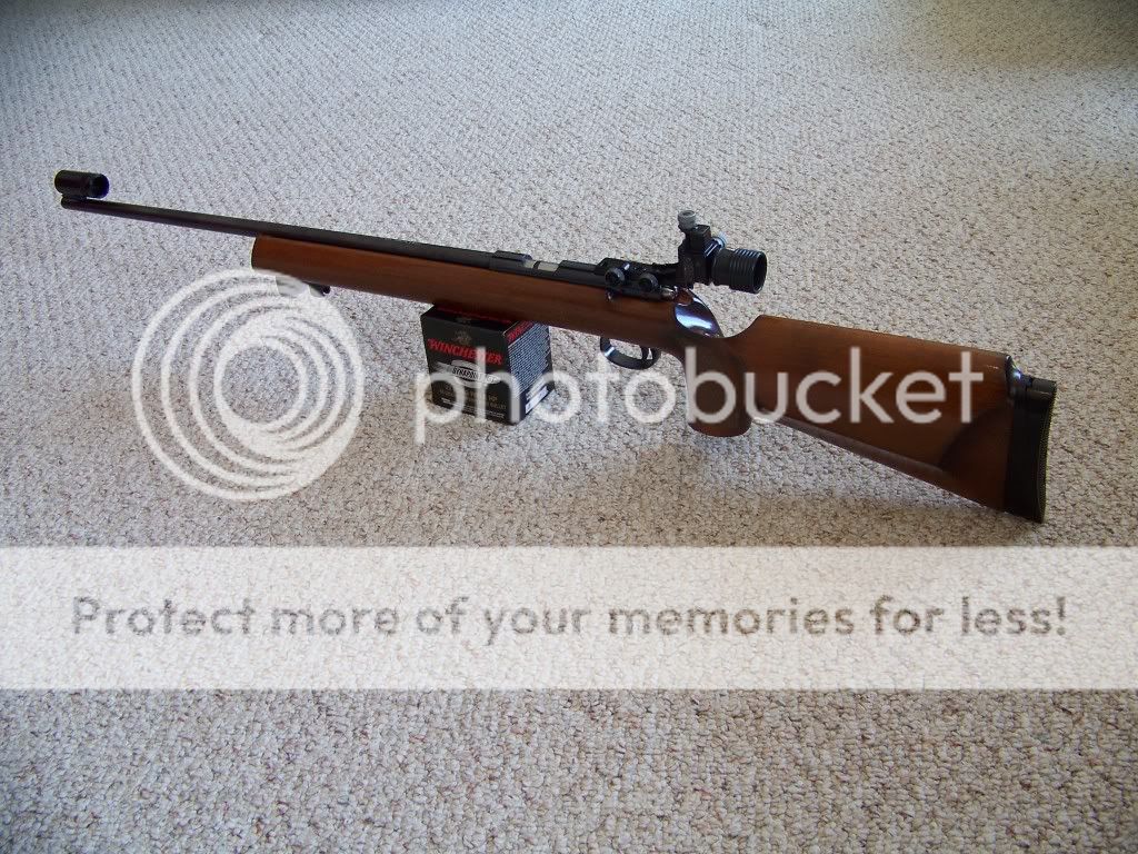

So, I finally found one of my must have rifles, a CIL 190. Bought it off the EE, in very good to excellent condition.
Was going to test drive it today, but we have had gusty winds all day. Maybe later on this week.

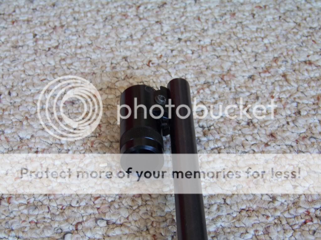

1) There is a small roll pin sticking down out of the sight barrel, which prevents the sight from sliding all the way onto the dovetail. Can I just push the pin up into the barrel? Do I need that pin at all? The last pic above shows the pin and how it is up against the back of the dovetail.

I was considering buying that rifle....... ;) But already have one, just not quite as nice.
Yes, Target Shooting Products should be able to help you out.
The pin is there to make sure it goes on the same way every time - leave it alone!:D
The rifle is in pretty nice shape, if you go to the Anschutz website you will find it there, it is their 64 action sporting class rifle.
You can down load everything you need there.
This one looks like it was used as a lightweight match rifle ( hand stop nwith sling attachment)
