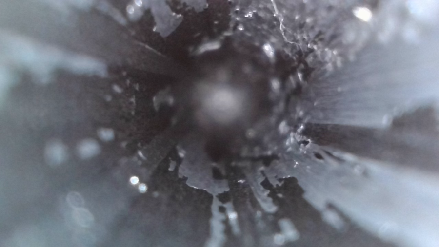

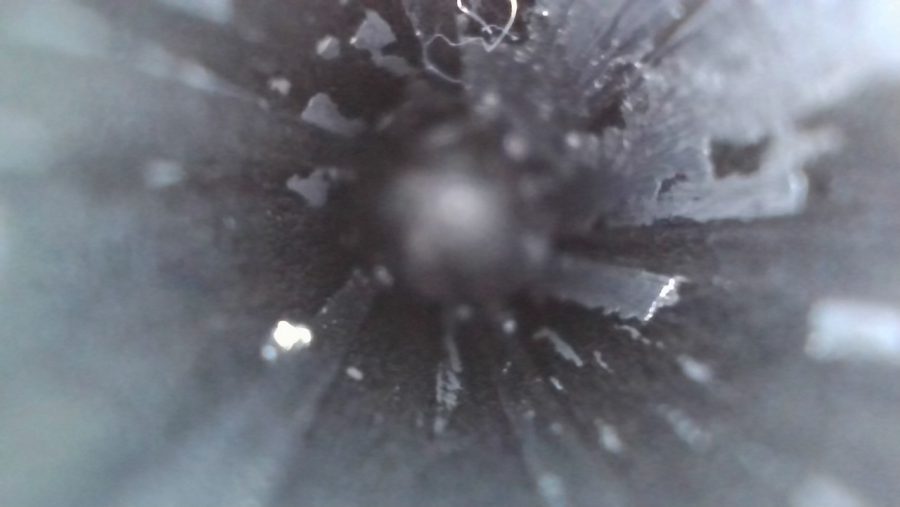

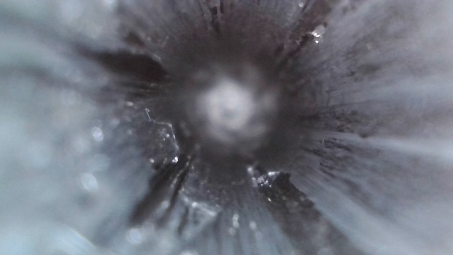

I’ve just done my second cleaning and found heavy lead and carbon ring about six inches from the chamber.
The fouling was so built up that my .22 cleaning rod couldn’t pass through, even with a lot of force! The fouling might be from all the ammo testing, but it’s definitely something to watch for, this rifle can burn through a lot of rounds in a session, and it really needs a thorough cleaning afterward.
I ended up drenching the innards of the barrel in Lucas CLP and Hoppe’s No. 9, scrubbing it with a smaller-caliber copper brush, and letting the bore cleaner sit overnight before I could finally push a cleaning rod through.

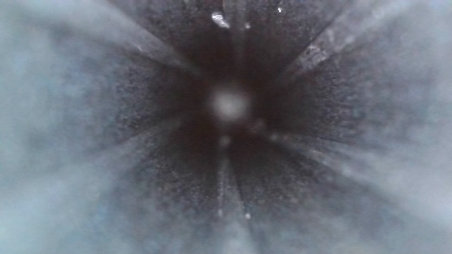

Here are some photos of my barrel even after cleaning with swaps and Hoppes No. 9 - the clean looking photo is at the muzzle end, the dirty pictures are about 6 inches from the chamber.
I just ordered a .20 cal brush and .17 cal cleaning rod to hopefully better scrub out the barrel.

Man, that looks pretty dirty!
Are GBs dirtier than other ammo?
I've cleaned mine after the initial range day of ~700 rounds, but I only used a bore snake with some Hoppe's bore cleaner (I forget the name of the solvent) to clean the barrel. I didn't inspect the barrel much, but the snake removed quite a bit of fouling. I'll have to do a thorough cleaning after the next time I take it shooting and inspect the barrel closer.
I'm hoping to get out again next week to run some more Mini-Mags, Blazer, and other ammo through this beast. I'll report back.
