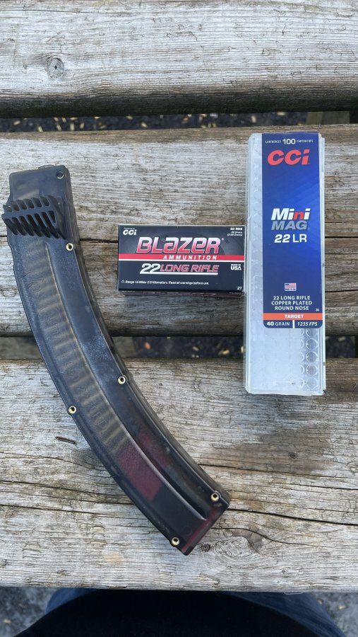

I have one and the 50 round drum and stick mag. I used remington 36gr high velocity 22lr ammo. The bucket of bullets 1400 rounds.Here are the types of ammo I have tested so far:
Both are jamming. I’ll update this list as I test more ammo.
- Federal Automatch LRN - 1,200 FPS
- Aguila Super Extra CPRN - 1,250FPS

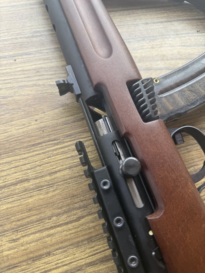

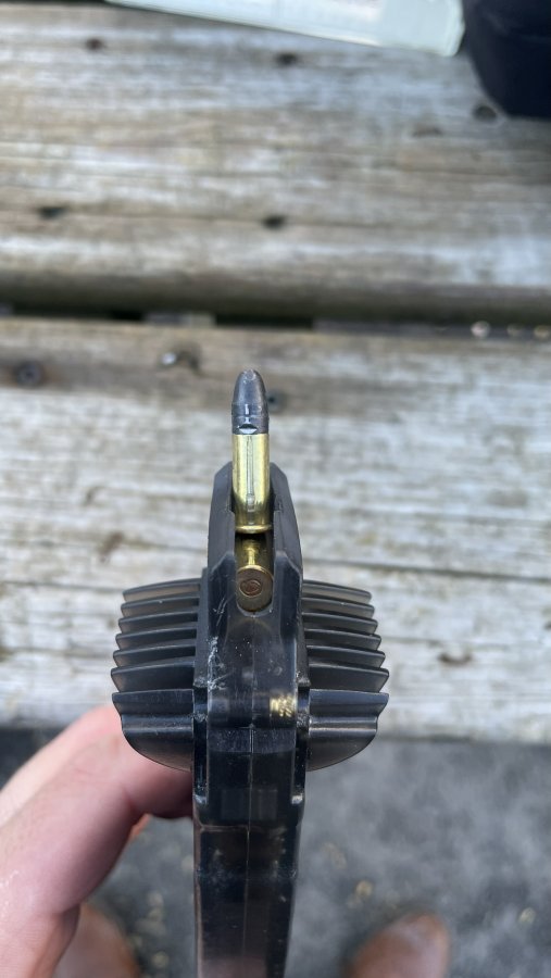

My issue is exactly what this poster described 16 years ago: https://www.rimfirecentral.com/threads/pietta-pps-50-jamming-bad.261091/ — the rounds are feeding too high into the chamber at about a 45-degree angle.
If I underload my stick magazines (20 - 25 rounds max), the gun shoots consistently. I have not found a trick for the drum mag.
Drum is plastic, stick mags are well built, both are made by Black Dog Machine LLC. I prefer the stick mags, they seem to be more reliable and the plastic better quality?
