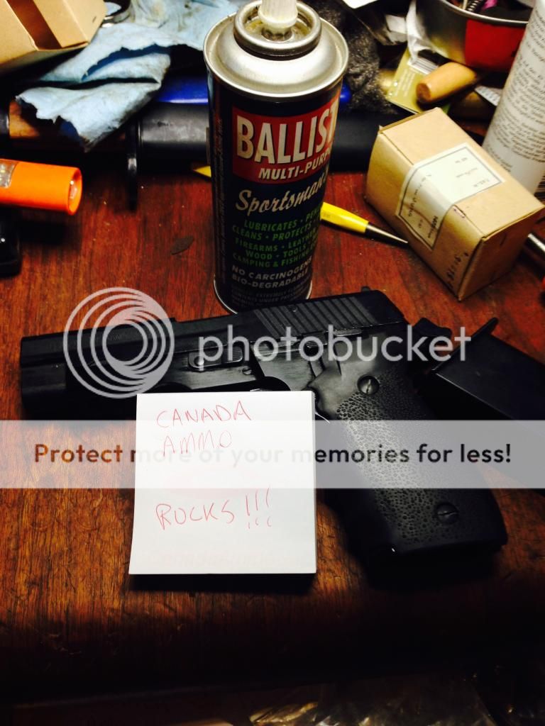

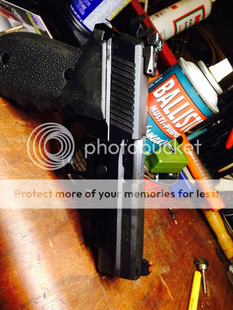

well got mine in the mail today. after stripping it and getting the grease out I lubed her up with balistol, got out 200 surplus CZ and headed to the range gotta say I pretty happy 200 down the pipe without a single prob.

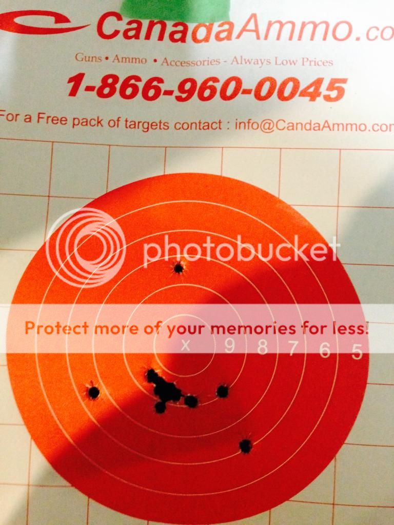

first target at 25 yards pretty gritty trig and getting the feel for it. not to proud of that one. drifted the site to move it to the right, and continued to shoot. things smoothed up considerably and I got the feel for it.
this is the last 10 first one allways goes high it seems. called flyer to the left, the rest aren't to bad. all in al color me very happy, so happy im just going to order another. thanks guys cant wait to get 4-6 more mags

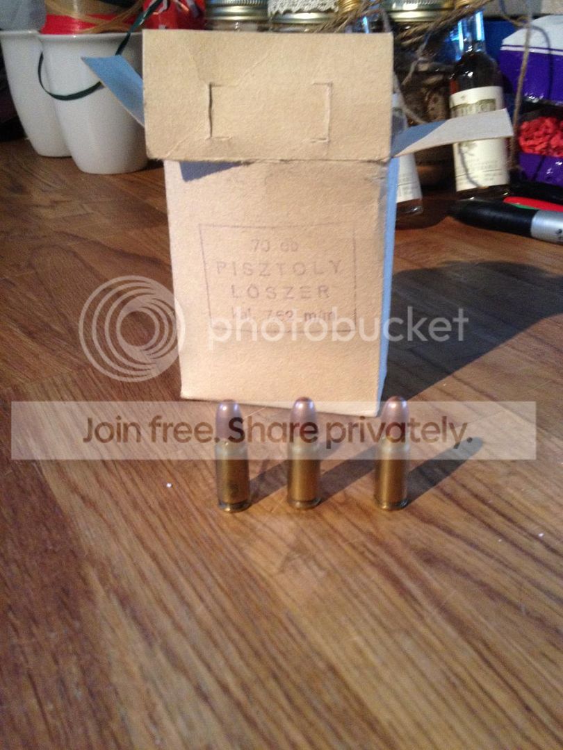

Mine didnt like the czech surplus at all....my surplus ammo was made in 1951 and out of 40 rounds I had lots of FTFs and 6-7 hang fires.
