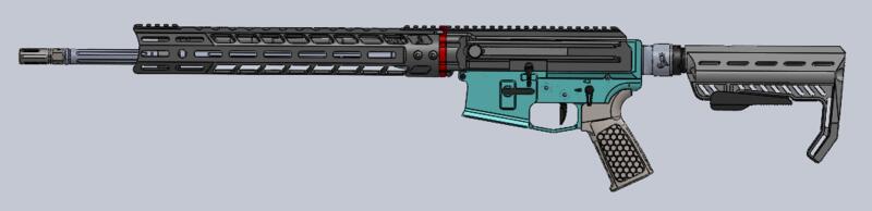

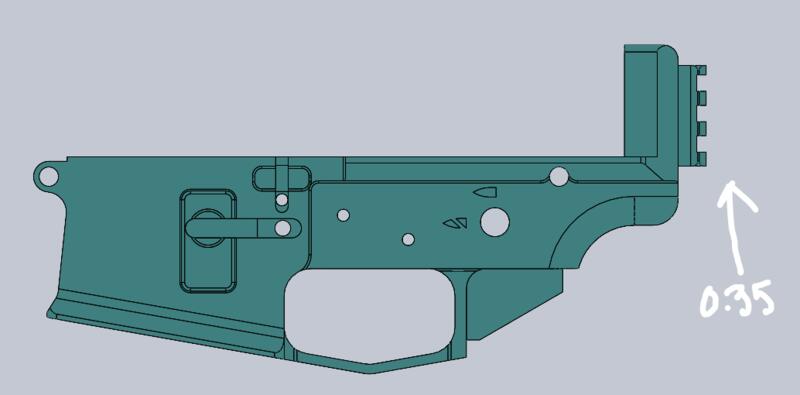

This is what we are thinking..... the stock now is in line with the bore. SAI raised the axis by .35"

Not gonna lie for such a small dimensional change that looks soooo much better and obviously has functional benefits for in-line recoil and optics mounting. Congrats on going from feedback to production change so quickly and I'm excited to see more reviews shortly
