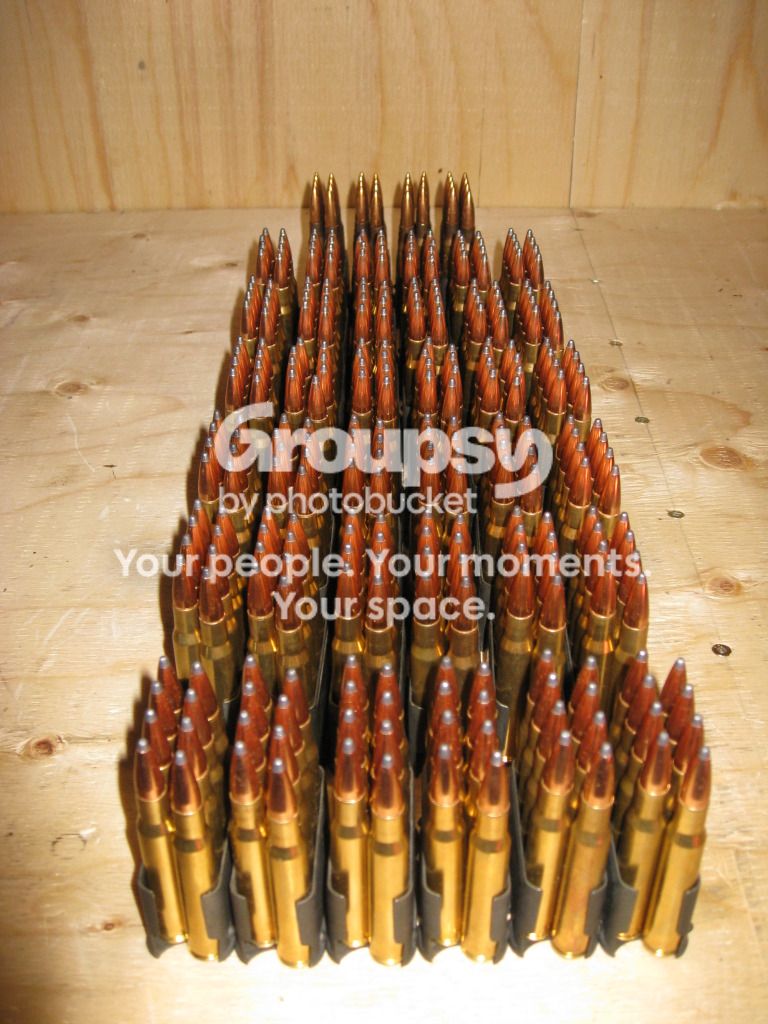

I put a slight crimp on my 30-06 loads for my M1 Garand for one very unusuall reason:
My chamber is so large that I only full length resize HALF the brass (still fits safely in my chanber). Becasue only half of the brass is resized, only half the neck is resized and there isn't much neck tension for the bullet seating. So, I screwed the seater down to apply a bit of a crimp and voila, no more neck tension issues.
