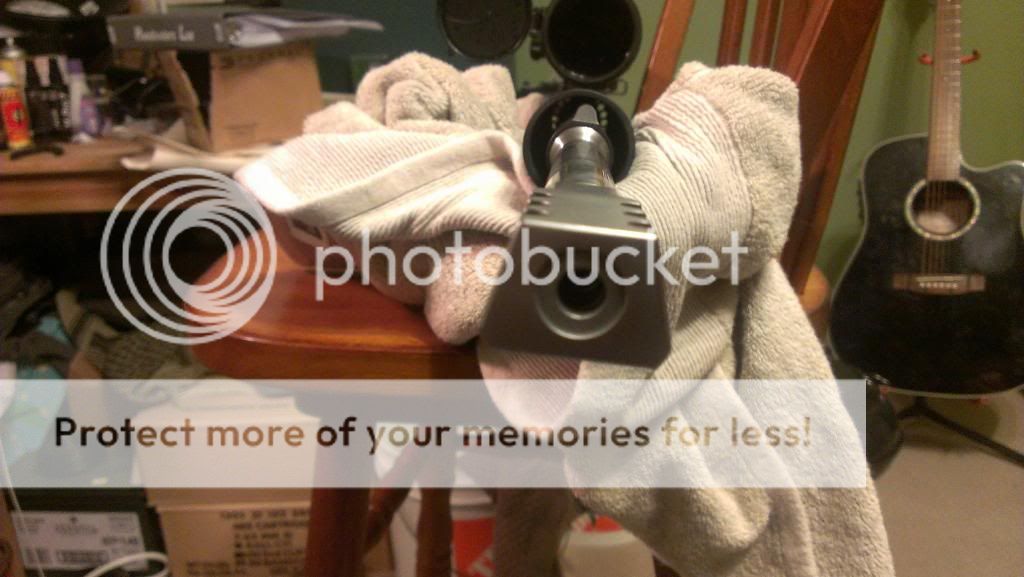

So I finally got my NSCC build out to put a few rds through. In the past I have shot only with a C7 and issue ammo.I've done quite well like that but always were there a couple of guys ahead of me. Keith C and Mark S usually. They both shoot nice rifles with handloads etc. So I figure this year instead of shooting military class i'm going to bring this badboy and some handloads and see what kind of damage I can do.
Specs are as follows.
Armalite lower with Geiselle 2 stage service rifle trigger supplied by Walter at Armseast.
Armalite upper.
22' Kreiger barrel with a .223 Wylde chamber cut by Kreiger and supplied by Mystic precision.
Low profile steel gas block.

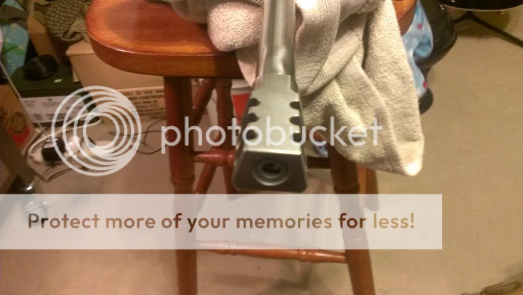

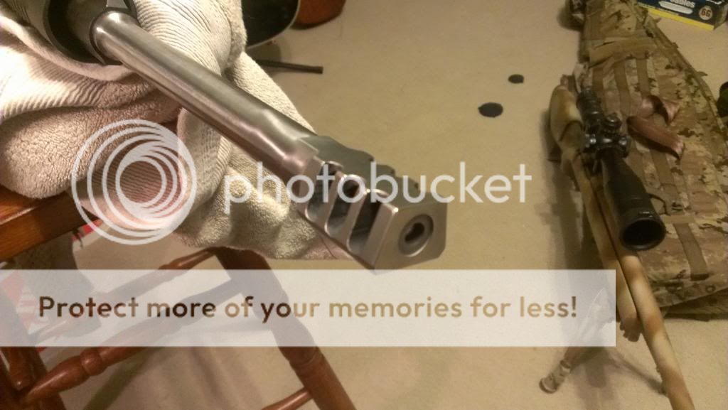

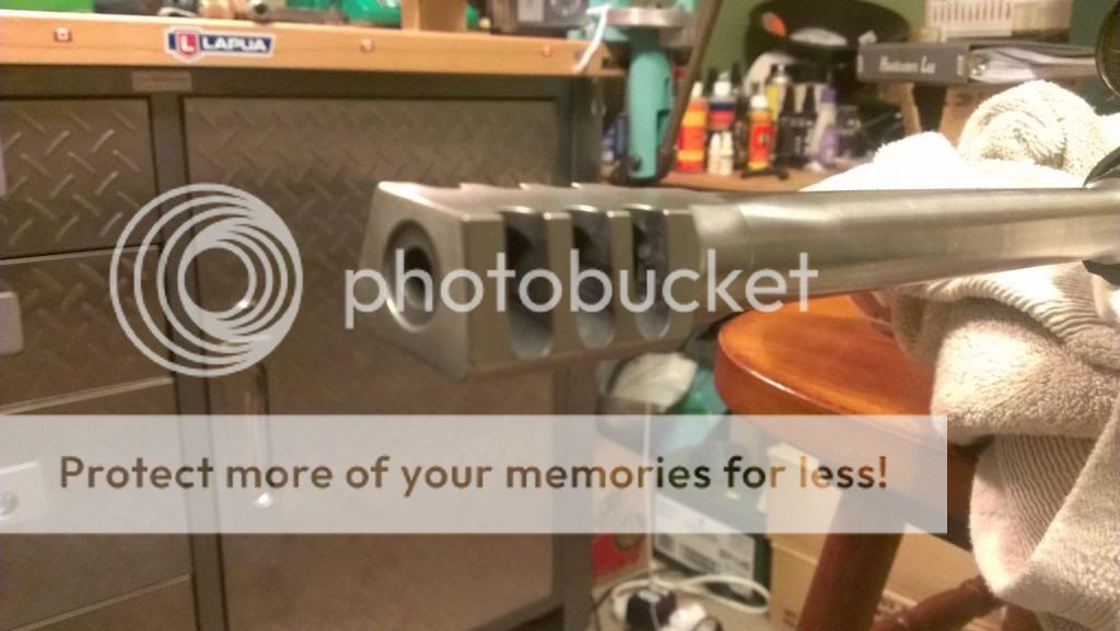

Barrel was originally 26 inches long so my good buddy Grensvegter trimmed it down and turned the bit in front of the gas block to .75.
He also machined from scratch the 3 gill muzzle break I've nicknamed "the cylon". Both barrel and break are stainless.
Optic thats on it in the pic is a Leupold Mk4 6.5-20. NOT the optic i'll be running.I put it on to test accuracy and break the rifle in.
End product looks like this.
The "Cylon" looks like this.

There is zero muzzle jump with that break on there.Its a kitty cat in rapid fire and so tame I can see my own hits. Grensvegter has outdone himself again!
77 grainers with 24.5 is a relatively stout load and I was expecting a little jump but I could easily compare the recoil to my .22 anschutz target rifle. It just doesnt move! Awesome!
