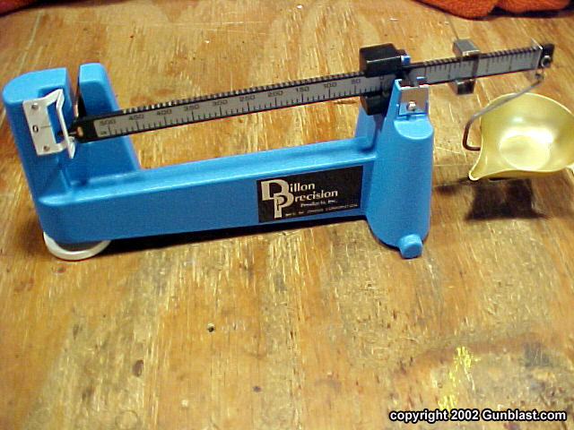

I'm looking to buy a scale, I'm new to reloading, starting with pistols, then reload for rifle too..
Considering Dillon Eliminator
Or would I be better off to look at a digital scale?
Don't want to spend a tonne of cash..
tia

I started reloading with a beam scale (RCBS 5-0-5). While it does a great job and is plenty reliable, weighing powder with a beam scale is the SLOWEST part of the whole process. You will instantly realize a huge savings in time by using a Chargemaster, and your rifle ammo will still be plenty accurate.
For pistol, if you have a powder thrower and can use the scale to set it up, it should throw powder accurately enough for plinking ammo. You can also use the thrower to under-throw a charge into the pan, so you only have to trickle up a small amount to save time.
Having said that, I don't currently have a proper bench, or anywhere to set up the thrower for use, and if I had to weigh each charge on a beam scale, especially for high-volume use like pistol cartridges, I would probably go insane.
If you're a low-volume reloader, and only shoot very occassionaly, a beam scale will serve your purposes fine. Any more than that, and you will quickly outgrow it.
