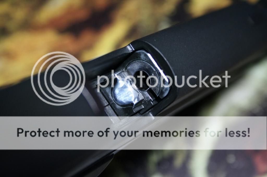

Could you elaborate? I've got a p226 with a 22lr conversion, that likes to fail to feed more then anything else (jams the round at an odd angle and deforms the bullet). Pics would be great!

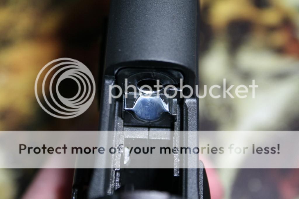

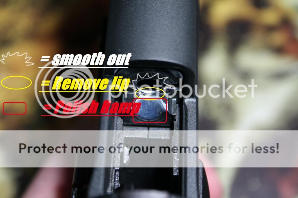

You will need a dremel or similar rotary tool, a cone-shaped polishing tip, a cylindrical polishing tip and some polishing compound ( I use green for my strops and gun stuff ).
The feed ramp comes from the factory looking like ####, rounds don't run up it smoothly. Use a cylindrical polishing tip with a small amount of polish to smooth out the ramp. Do not remove much material, just get it smooth. At the top of the ramp, there's a lip where it meets the breach / chamber, that needs to be taken down a little so that rounds don't get hung-up on it. I used a cone-shaped polishing tip and compound to smooth out the lip. While I was doing that, I used the same tip to open the breach slightly. Mine was also out of round so cheaper ammo would get stuck. Since doing these easy mods, my gun runs great. It has fired every type of ammo I put through it. I still prefer CCI Minimags because they seem to be more consistant and of higher quality.
I will take some pics and post them asap.
Great pics, thank you very much ! The more I read the more your fix comes into play. It seems to be the largest area of concern that gets fixed by your methods. I recently watched a video from Buds Gun Shop, in the US, on the Sig. He states to break the gun in by using CCI Mini mags then you can use just about any ammo. Other people say the same thing and yet others say you can only use the Mini mags. I think proper break-in and your fixes would go a long way.
