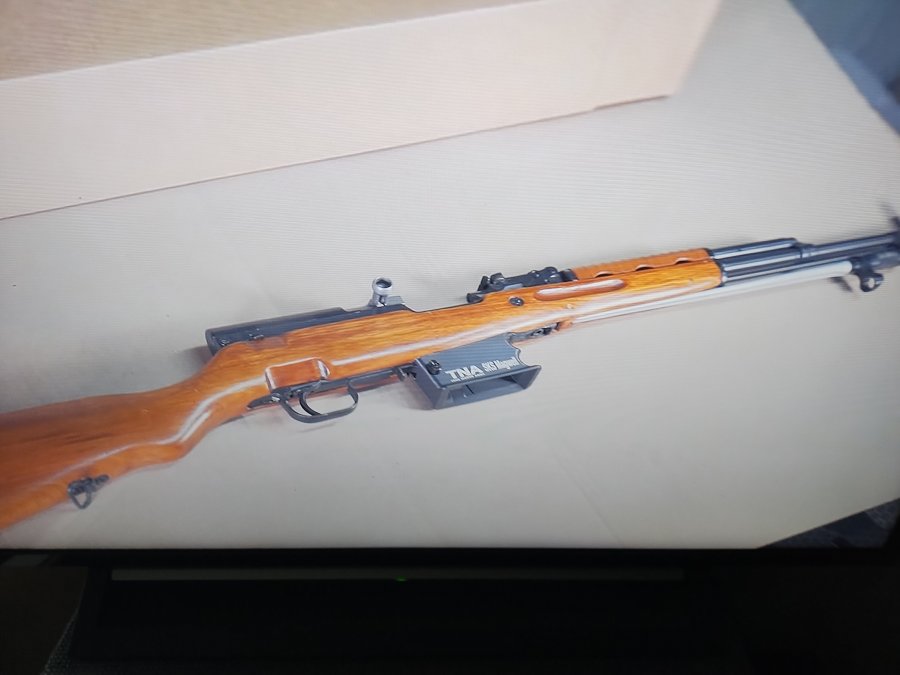

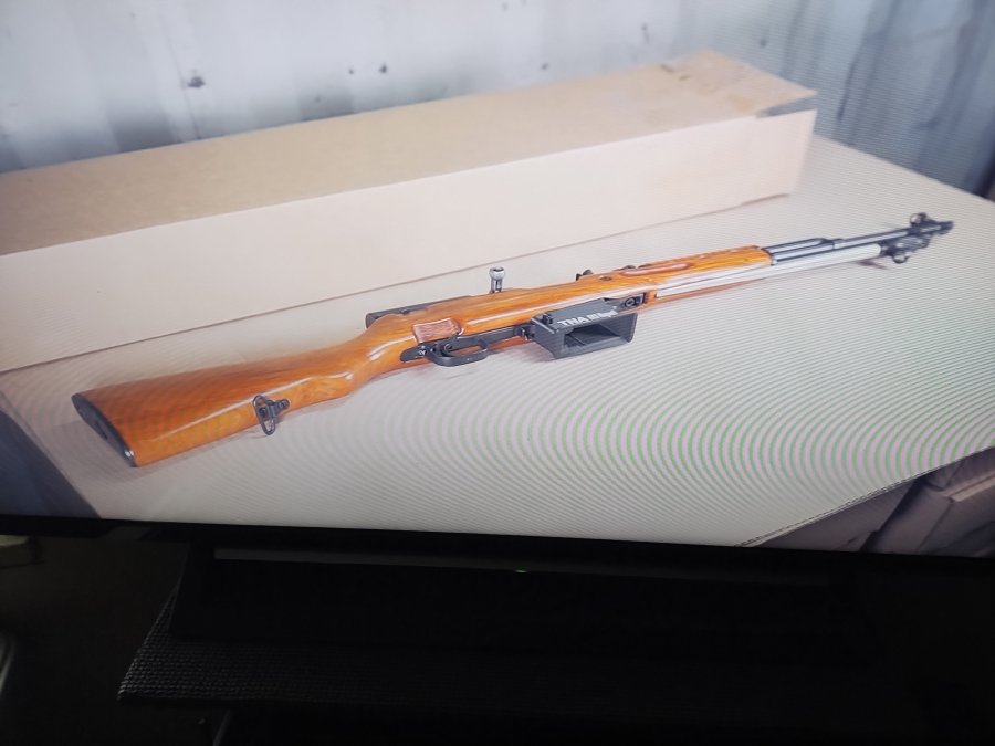

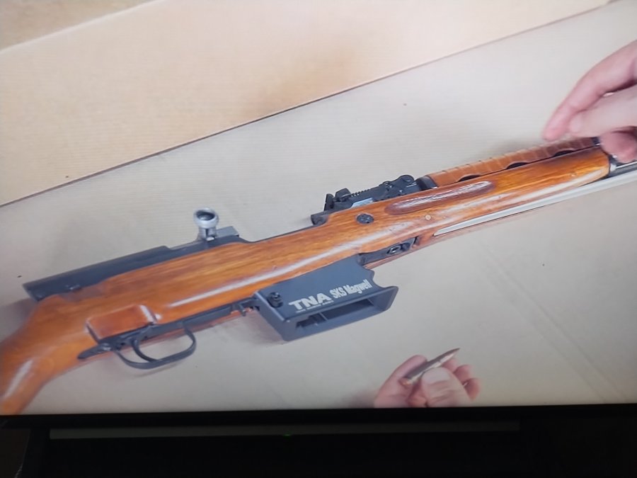

any pics of one of these installed on a rifle?
