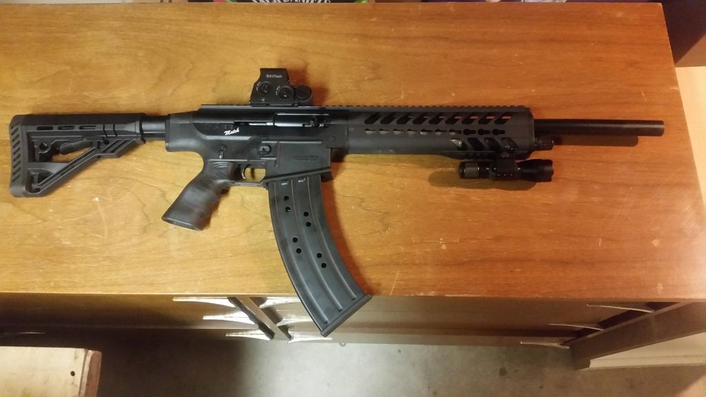

I upgraded the lower receiver to a Tooth and Nail SAS forged aluminum receiver, new trigger group, down to 4 lbs trigger pull. With the new receiver you can change grips and stock to any AR-15 funiture, AR-15 Safety and new breacher choke. I need to get a larger charging handle, I thought from the picture from the Gun show that it was larger, but it was just the rubber protector.
What do you think of the new lower? Good bang for your buck? Looks really good!
The fit and finish is really nice, was really easy to install, I just had to move my mag and bolt release over to new receiver, took me about 1 hour to convert everything over. I have never been a big fan of polymer gun parts, but that is the way these days. I think this is a perfect addition for these guns. I am getting a lot of messages asking where I purchased the receiver from, here is the link, I dealt with Matt he is one of the owners.
