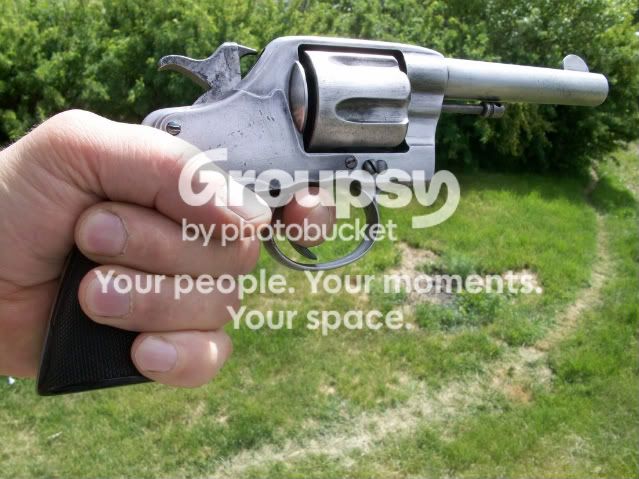

A new and expensive addiction
Got it from a fellow CGN'r who got burned on it...but we came to a mutually beneficial agreement.
It likes me more anyhow:)
I can get it re-nickled locally for 150-200.
100 $ worth of parts from Numrich & perhaps some handmade wooden grips.
Shining and shooting in a couple months.

I think your crane screw is coming loose in that photo...

The gun was carefully & temporarily re-assembled for the pic's ( so the screw is most likely loose), LOL. As soon as I get to work(where I'll have time...ironically enough), I'll be dis-assembling it and delving deep into the mysteries of tuning it up ( coffee ...STAT!).
