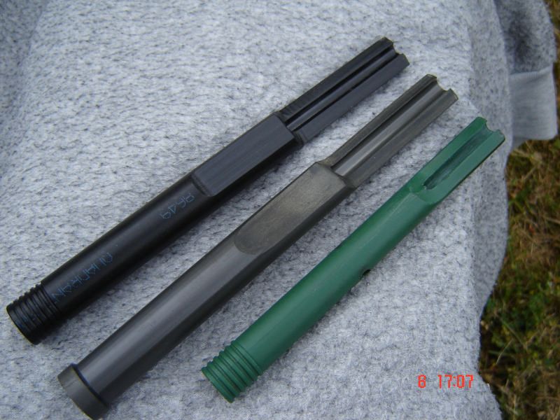

I don't mean to hijack this thread but: Does anybody know of any source for a bore guide for those vintage Walthers?
Thanks
Gilbert
Tank you diopter. I already have a bore guide for my Annie 54 action rifle. I'll try it.
Gilbert

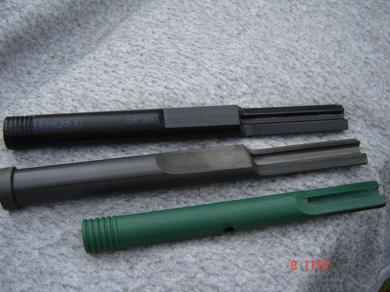

The rod guides on the left are custom made for Walther KK series of the 70s and 80s vintage. The green guide on the right many of you may recognize .... Anschutz part #4401 rod guide for 54 actions. The Anschutz guide will do in a pinch but a guide that fits more snugly will do the job much better.
Looking on Possum Hollow's web site - they no longer offer a Walther guide , if they did.
edit: Thanks diopter for reposting the pic - here's another ! I forgot about Lowey's in Australia
So the Anschutz 54 guide will fit. Great news! As a side note, for those interested: Before you guys posted, I had already sent an email to Eric Sinclair at Possum Hollow. He just answered and it seems he will do guides for the Walther KK and deliver to Canada...

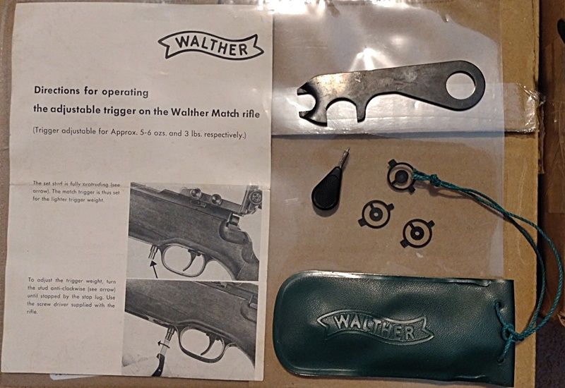

Some further information to muddy the waters on the nature of the trigger on the KKJ-T. This information comes from a source usually considered reliable, which is the manufacturer.
The following are the "Directions for operating the adjustable trigger on the Walther Match Rifle". Note that the photo on the instruction sheet shows the same trigger as the KKJ-T trigger, complete with the "set stud," as Walther terms it.
This trigger is adjustable down to 5-6 ounces and 3 lbs, respectively.
To the left of the upper picture of the trigger are these instructions. "The set stud is fully protruding (see arrow). The match trigger is thus set for the lighter trigger weight." (Emphasis mine.)
To the left of the lower picture of the trigger are these instructions. "To adjust the trigger weight, turn the stud anti-clockwise (see arrow) until stopped by the stop lug. Use the screwdriver supplied with the rifle."
Perhaps the trigger is not a set trigger (if it is, in this case it would be a single set trigger). Nevertheless, it's hard not to take note of the terminology used by Walther.
And the OP might be interested and pleased to note that a number of posters on RFC who have used this trigger say that it does indeed go down to ounces, rather than the pound-and-a-half referred to above.
See h t t p://www.rimfirecentral.com/forums/showthread.php?t=412384
h t t p://www.rimfirecentral.com/forums/showthread.php?t=673305
h t t p://www.rimfirecentral.com/forums/showpost.php?p=6676425&postcount=8
Good to see there's a stop lug.i stopped turning it out figuring the screw May fall out and get lost before I had it lighter. Thank you Glenn.
