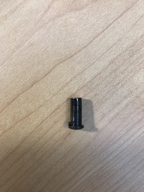

I took a look at the hinge pin. It appears to have a very slight bend on one end, where the hinge screw threads into. It is bent forwards, in the down-range direction. Perhaps this is offsetting the barrel forwards, resulting in the gap. I wonder if I can get a replacement for this part.....
