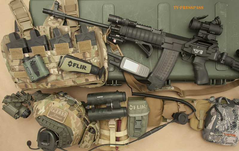

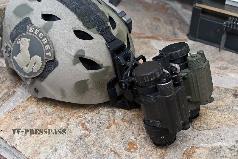

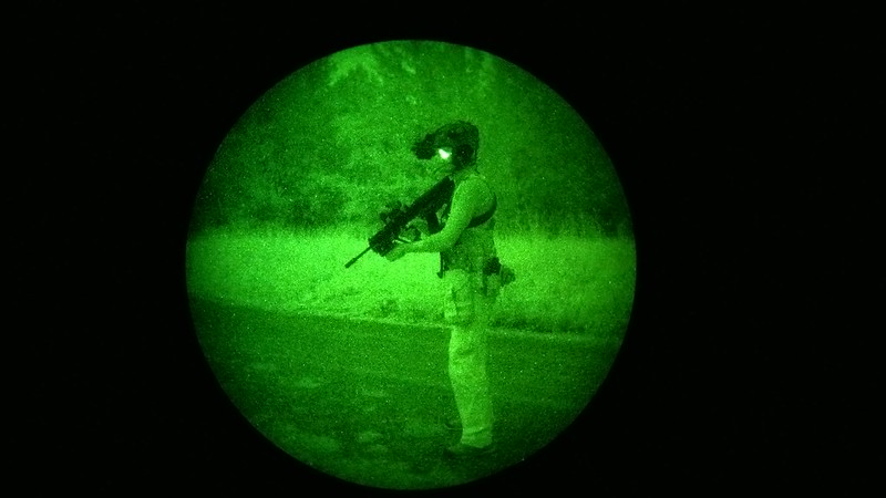

And because that was a really long post, lets get some photos of my gear in here...
Zip.
Zap.
Zop.
