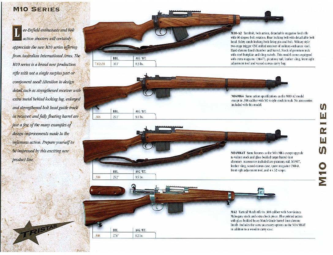

Did anyone see the thread in the General Firearms Discussion forums, where Marstar is taking orders as of today, for Australian built repro No.4 Mk4 (.308) Enfields for $700?
I'm curious now ........ are there any milsurp members who are going to buy one of these, yes or no ... and why?
No.4 Mk4 is second from the top
Click PIC to ENLARGE

I examined the guns that Mike from Marstar brought to Connaught. These are not Lee Enfields, nor are they replicas. These guns are new, and somewhat resemble a No.4. There are several significant differences that tip the balance.
The front sight block is threaded onto the barrel and snugged up with two screws. The sight is a screw pin. Kindof fine but definately not a slab like the No.4. The barrel is free floating, and is secured with a Savage type barrel nut. The top wood is clipped onto the rear of the barrel. The front band is a hinged style like the very early No.4. The stock is just a handle, held in place by the King Screw and the back of the trigger guard. The receiver is much thicker than any military No.1, 2, 4 or 5. It uses the Mk1* slot vs the Mk1 release button, which makes it much stronger. It has the hung trigger. One guy observed that it could benefit from a tiny set screw on the trigger instead a first pressure bump. The bolt face is recessed, and headspaces to the barrel, with no exchanging of bolt heads. The 7.62 NATO magazine is very similar to an M14, except for a sloped catch lug, and no front spring guide rod hole. The mag well is a pinned in box that gets past any reciever feed lips. It uses the familiar side safety. The back sight base is compatible with the WWII slide sights. Finally the Weaver scope base has four recessed screws - two on the bridge and two on the receiver ring. (The left side wall has a few sculpted grooves so a side mount is out of the question.)
The choices are Enforcer style, military full wood style, jungle carbine style, 7.62x39 carbine (with AK type mags) and accessories to make a T-style scoped rifle. I like it because it is a 7.62 detachable magazine rifle, and has a modern barrel nut. Show me a US made detachable mag rifle without needing further gunsmithing to be field functional?

The No 4 Mk 4 series rifle is a beautiful deep grey parkerized finish, with all the features listed above.
I'm wavering on getting one, I love the looks, and the feel.
The stock is slightly thicker than an enfield in the vicinity of the receiver due to the beefieness of the new receiver.
The M-10 series does have a tanker model.
Apparently, the company in Aussie-land test-fires every rifle for groups before they finish assembly, and all must fire within a 75mmx75mm circle (similar only more stringant than the WWII standard of a 75mmx100mm box)
Those rifles that are able to shoot better than 25mm groups are returned to a seperate production line, and re-barreled into L-42 clones.
I like, and I'm leaning hard towards one of those, if only they had the parkerized finish instead of blued.
NS
Rather than comparing these rifles to existing Lee Enfields, it might be better to consider them to be new, military styled rifles. With the heavier receiver, .308 caliber, detachable magazine, scope mounting capability they may well be useful rifles in their own right. They are priced competitively with current sporting rifles; don't compare the price with Lee Enfield prices.
