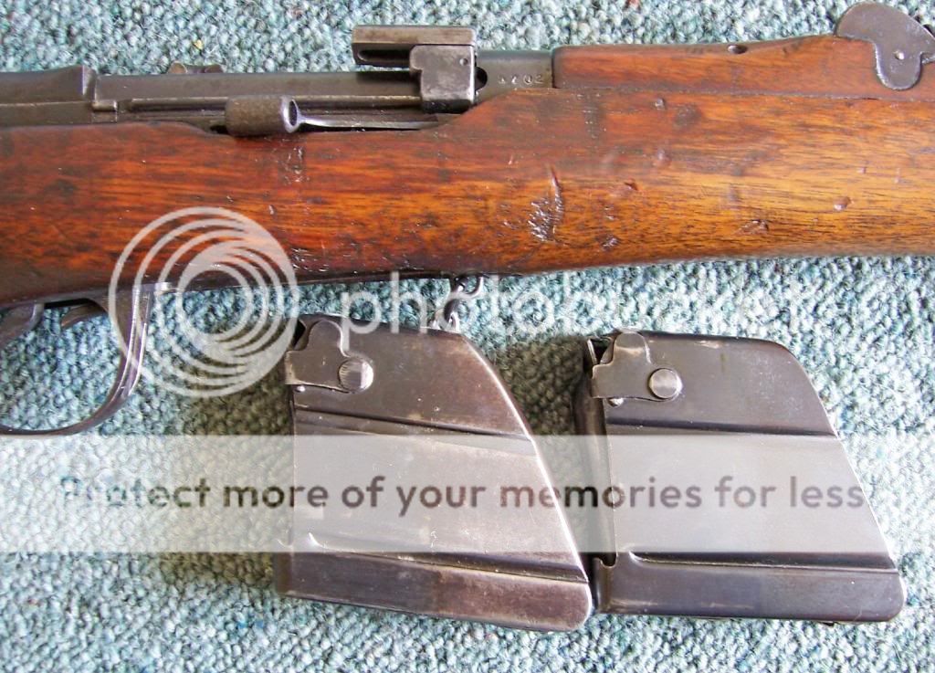

Thats it Smellie, while the different magazines were never designed to interchange, due to their similarity some do readily while others do not but you can get the same result from magazines from the same model.
As for experience, 30 odd years of collecting rifles that are quite commonly found around NZ, some fitted with the wrong magazines (that still function fine) & then trying to refit the correct magazine to them has told me a lot about the interchangeability & in the early days of my collecting i fitted a magazine from a Mk1 SMLE into a Mk1 MLE, it went in but it was a complete B.....d to get back out, i did succeed but not without causing some damage first.

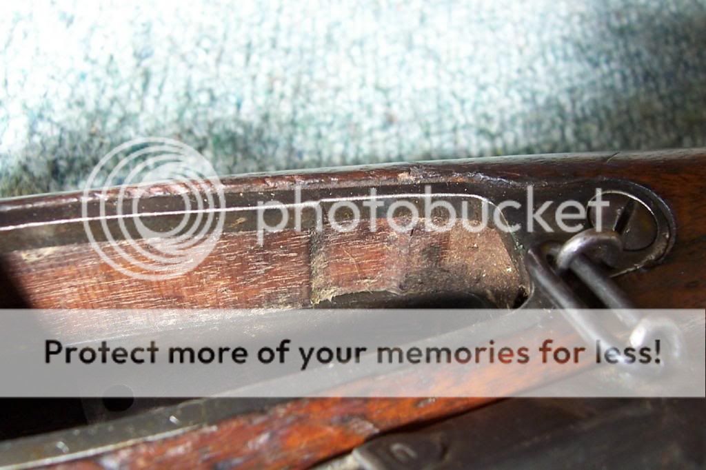

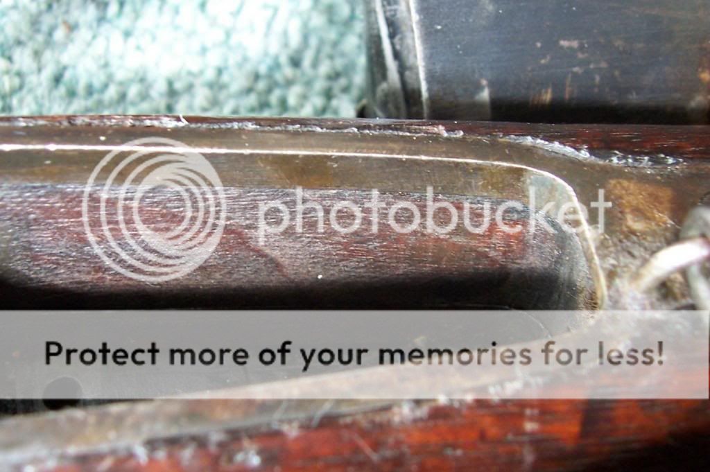

Type 1 & type 3 SMLE mags
Mk1 SMLE Mag well you will find the same clearence cut on MkIII SMLE.
MLE (LongLee) Mag well
Some do some don't
