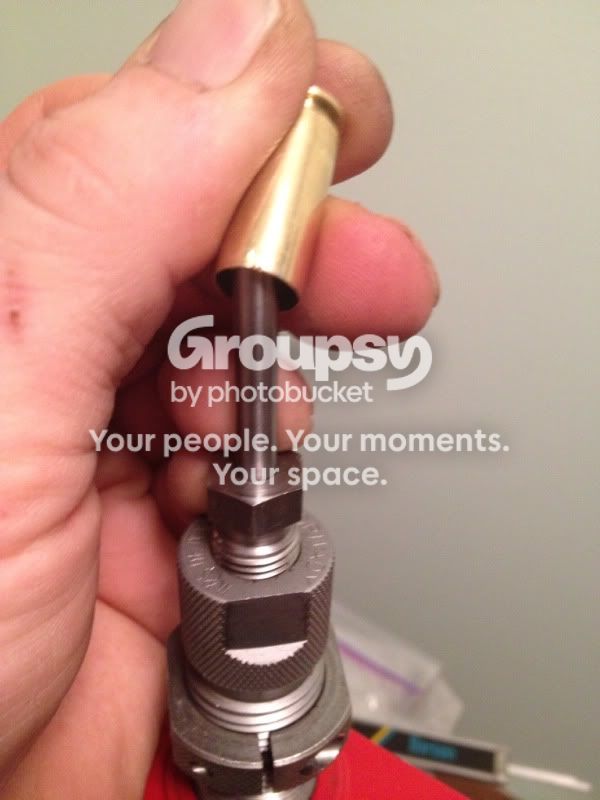

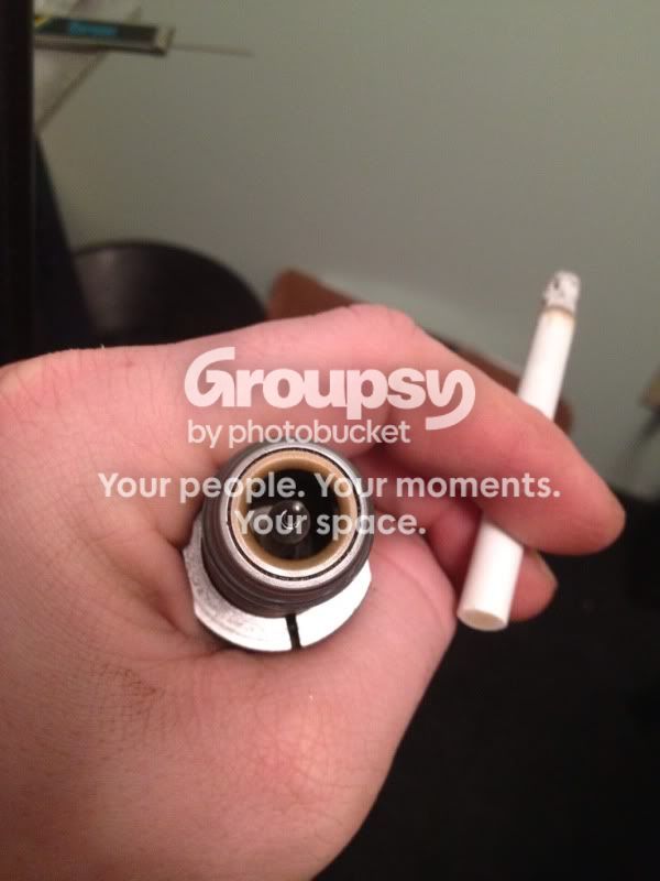

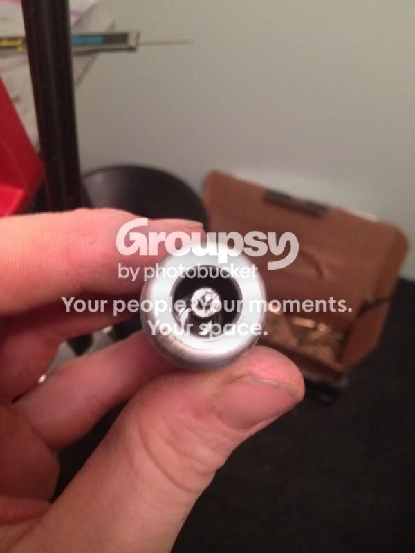

Howwzit that thy die doth do s**te to that wretched case neck whilst my own would smush it straight with the world??![]()
Ahhhh grasshoppa....
Some dies only have a thin decapping pin, that is the uber rare rhino stopping mall ninja repelling wrist breaking 10mm N-BUM cartridge (Non-Belted Ultramag'allmost) in said pic... Dies are older Hornady ND dies I got used off the EE... Straight wall pistol cases don't require the expander feature in a FL die as they have expander/flare dies in there family set to round out the case mouth and expand the case to accept the bullet whilst adding a slight bell to the case mouth... Wow that's a lot for 1 lonely die to do huh?...
