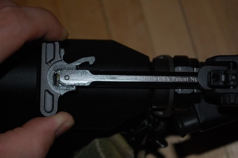

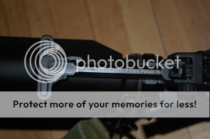

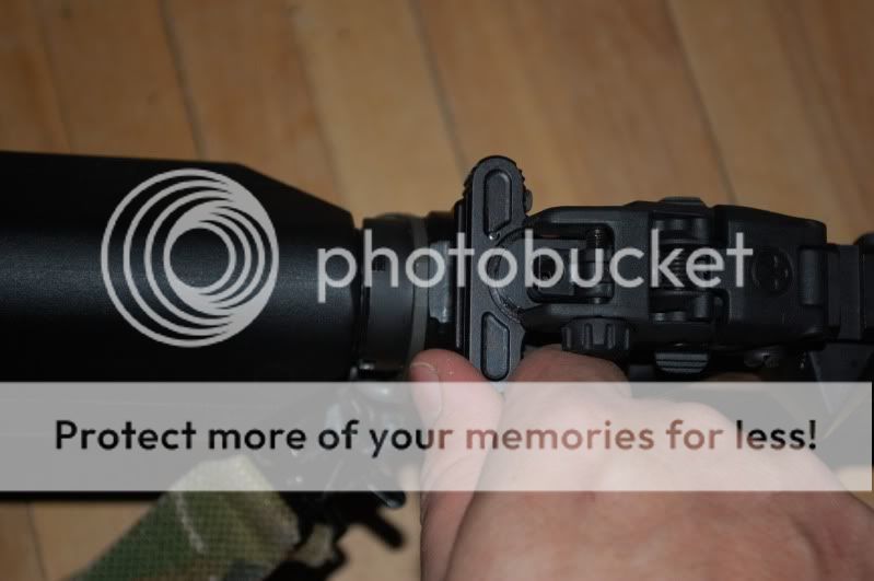

Charging Handle; Armadynamics Ambi!!!. Charging handle is the biggest beef I have with the AR platform, my lord what a stupid design. I think most have just accepted it because its how they're trained. If you're a lefty man its terrible, there's just no efficient way to work it. Then came Armadynamics, these guys are plain brilliant. What a smart design. I ran about 200 rounds with this yesterday and it works like a charm. Simply pull the handle back and you can cycle the action.
One thing I don't like is that the carrier can't be locked back for the left side to function. It needs the spring pressure of the carrier to operate. I honestly can't think of any situation where this would be a huge issue but its still something to note.
Now if only they could make the charging handle integral to the carrier and further forward the AR would be close to ideal...
