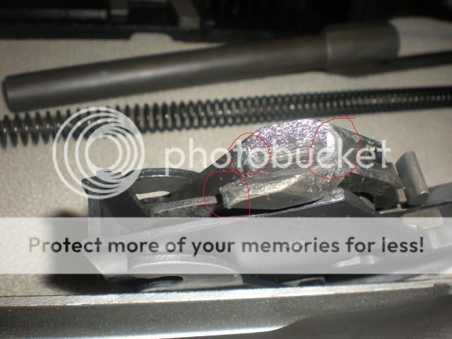

Ok so the gas system is tight. I took the gun apart again and cycled the action without the trigger group installed and it doesn't bind at all. It appears that the bolt is binding on the hammer almost to the point of stopping the bolt mid-cycle. Here is a pic of the wear marks on the hammer:
Normal wear for 100 rounds?
Interesting pic. Is that grease on the hammer, or a severe case of galling? ...when two sliding metal surfaces dig into each other, simply put....
Maybe the problem is inadequate lubrication?
Picture looks fine to me. Go and shoot it like crazy. Hey, what do you expect from a high school shop class for $ 400? An M1A or LRB receiver? :eek: It's a $ 400 blaster!

So with the trigger group out can you push down on the hammer when its locked n the down position (cocked not released) Should be some play. See, this is why Hungry says to buy two. One can take parts off the other and swap around to help trouble shoot.
