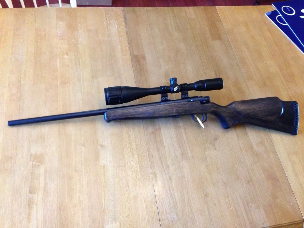

I have been following this wee rimfire for quite some time and when a used one for a sweet price popped up on the EE it was perfect timing for a winter build. I wont bore you with the details of this rifle, but word is, it is supposed to shoot very well and let me tell you, it sure does.
My goal was (is) to turn this into a sleeper and surprise my local Silhouette team with its accuracy. I will break this down into several stages, ( as time allows) but the stinky Tung oil stock needs to go first!

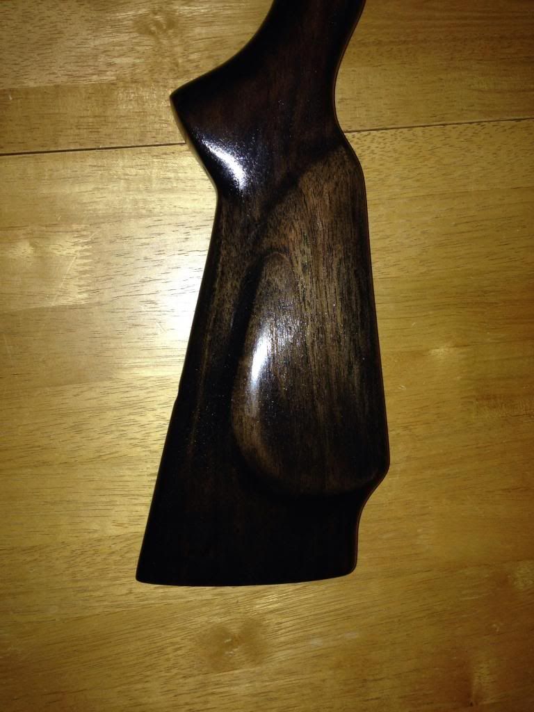

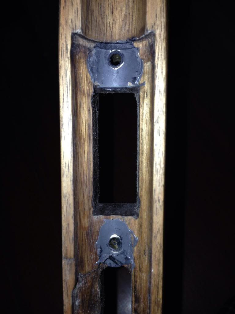

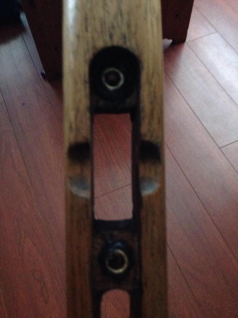

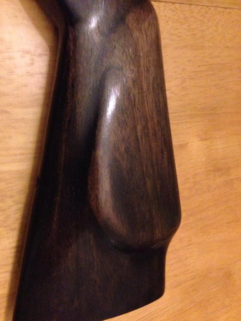

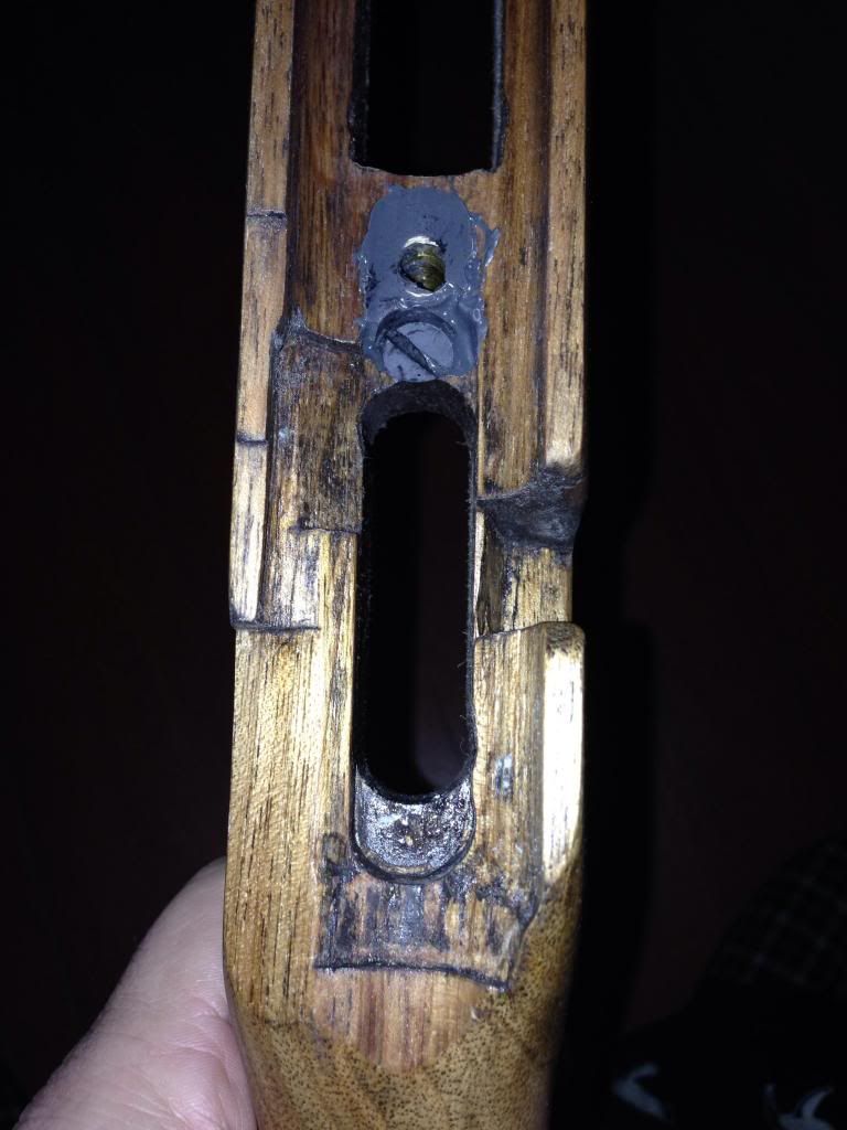

The previous owned had done a swell job of stripping the stock and putting 3 full coats of Tung oil for a nice oil finish. It looked great, but Tung oil smells like unholy death to me and I couldn't stand it. I stripped the stock and applied a nice dark (Ebony) stain as well as 4 coats of polyurethane gloss finish. I chose Ebony, as I wanted the stock to be as dark as possible. Just what I wanted, no other reason. Since I was stripping it, I installed the dual pillars and glass bedded the action AND bottom metal. Since this stock was made for a completely differnt (EM322) rifle, I needed to do 3 separate epoxy sessions. This gave me the results I needed/wanted due to dealing with such a loose fitting "stock". For those who are not aware. There are metal spacers under the factory bottom metal to try and get this stock to fit right. I chose to extend my pillars and bed deep the surrounding area with epoxy. It worked perfect.
It looked like the "inletting" was done with a dull chainsaw.
