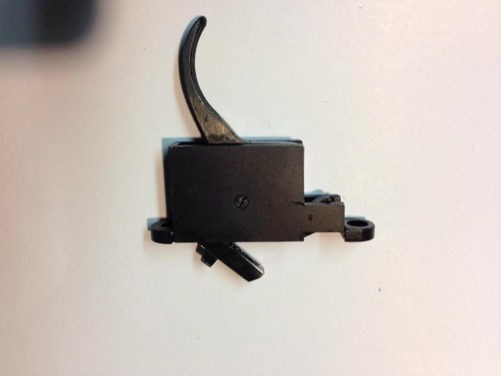

Gents, meet Mr. trigger group:
After removing the two slotted screws (the larger from outside and the smaller from inside the receiver) the nicely housed trigger group lifts off

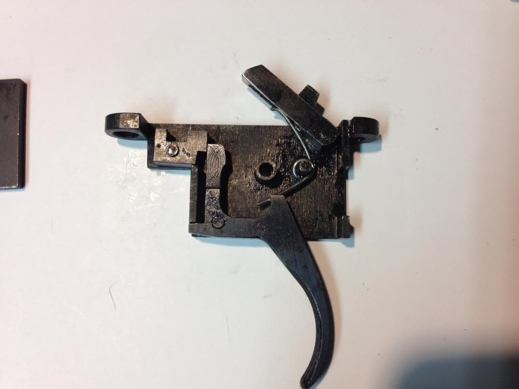

After removing the tiny slotted machine screw from the cover the groups side cover plate lifts off. Rewarding isn't it?

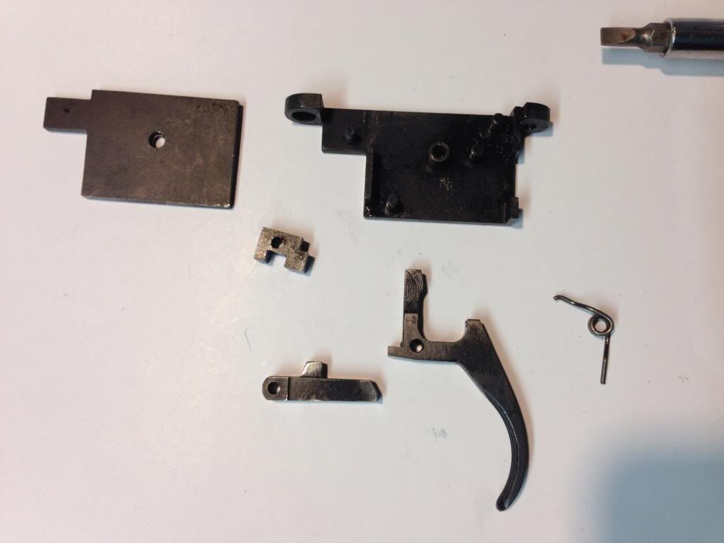

Gutted!!

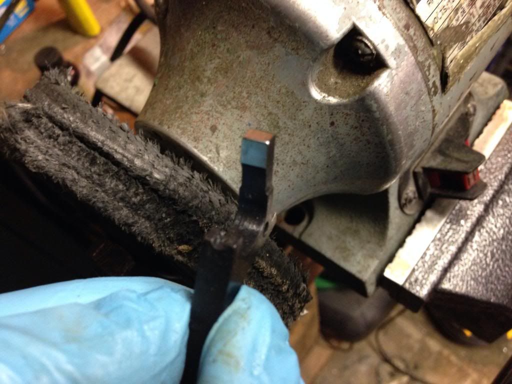

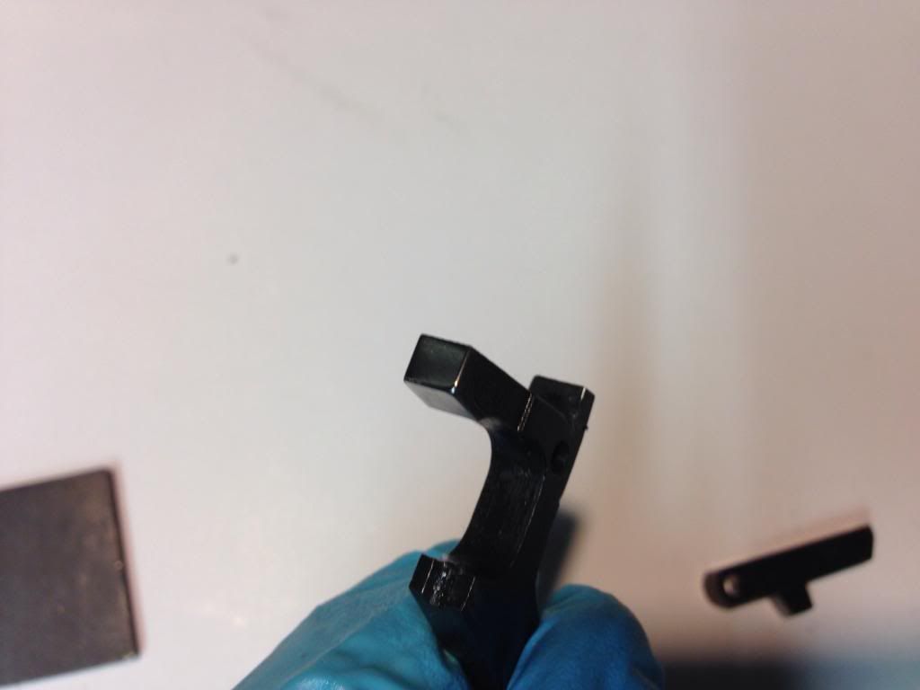

Now, about my polishing methods. I am more into polishing and reducing drag than stoning and stock removal. It has been my experience to polish first and then remove material if the triggers pull is still deemed excessive. If you don't like doing things twice in the name of quality and or safety then grind away. I have a fair amount of background tuning hi power spring piston air rifles. I never will fully buff or polish a surface. A mirror surface looks great, but it will shed any lube or oil on its surface. You need some texture to hang on to the lube.

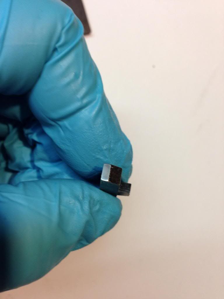

Oh that wee b@st@rd of a trigger spring! One of the bittersweet things about the 522s trigger is the spring. It is very simple ( good) but it is not a coil ( lame) type. Non coil springs are fine, but harder to mod. The 522s dictates pull, but also the trigger reset. Too light (weak) and your trigger will fail to reset. I went on a spring saga and no ordinary regular spring would do. It had to be from China!!!!
This turned out to be rather simple (how odd) and I managed to source out a supply of trigger springs that fit the needs of the rifle perfectly. I wanted extras anyway, as I am going to need them for the other rifles I will get. Mine now comes in at 1.5lbs with only a slight creep, but it breaks soooo sweetly! Oh and don't worry. The rifle got a full bump and safety on off test. The sear profile never changed mind you, so it is still as safe as before.
I did my best to capture the spring differences. The larger of the two is the factory one of course. The washer is there just to hold up the half pint spring. In the pic I have not polished the spring ends yet , so they look rough.
