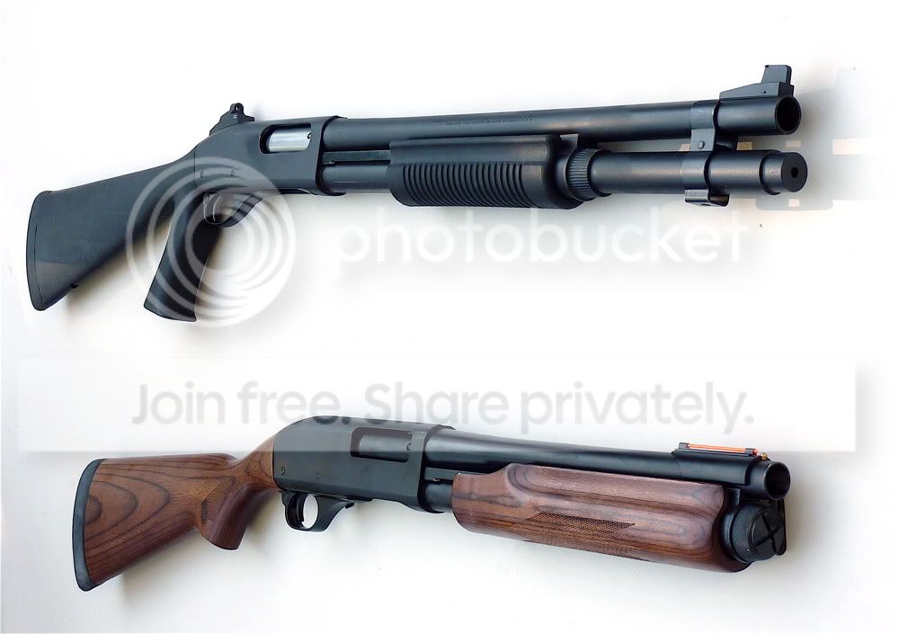

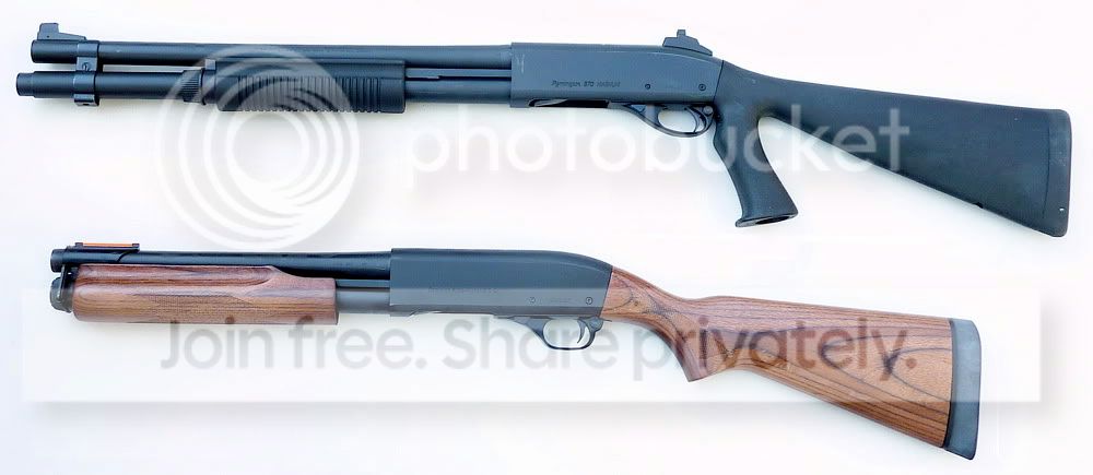

here is a Dominion Arms Grizzly with laminated 870 Express fore-end and stock (found random on google but ###y)
I got one last question about the owner of Remington 870 with a grizzly 12.5 barrel.. was is the exact overall length.. i dont want to know if its restricted or not, that is already pretty obvious but what is the exact overall length of the Rem 870 with a 12.5 barrel..

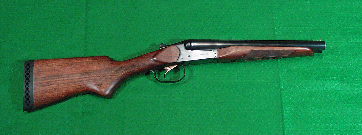

Tom E Gun , or anyone , what can you tell me about the short double coachgun in the pic . Sorry Doc for the hijack but i'd give my right nut for that coachgun with the short barrels and internal hammers . I have a Stoeger coachgun now but they don't make 'em with short barrels .
The exact length of a wood stocked 870 with a Dominion 12.5 barrel is 32 7/8 inches.
thank you very much for the info.. the few extra inch should not be too bad over a grizzly 8.5 in the shorty shotty world
EDIT: sorry to ask again but.. can i push you into giving me the total weight without ammo ? [is that beast hikable in long hike .. many days] ... guesstimate 6 pounds maybe ?
I'm pretty sure it was cut to that length. In the US you can cut barrels to any length provided you do the required ATF paperwork and pay a $200 fee. They have categories called SBR (short barrelled rifle) and AOW (any other weapon).
The only double barrel shotgun, that short, that I have seen in Canada is the DA Outlaw.
