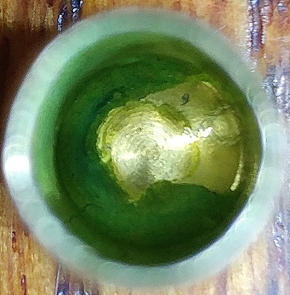

I pulled the bullet off one of my failed Browning cartridges. A friend who knows more than I pointed out that inside at the strike point, there is no firing primer. It is 2 o'clock in this photo. Will have to research (by taking more apart) if it flaked off or if it was never there. I put it in the vise and struck the other side with a chisel and it flashed off.

Did you check the powder you dumped out of that case for remnants of primer compound? Maybe the hit from the hammer made it flake away? Maybe its too far inbound to hit the other half of the rim and detonate so it just broke away some compound that then fell into the case?
I'd pull more of the missfires and see whats up with them after seeing this.
There is some remnants of the primer. Some green flakes in the others I took apart. The gun was purchased via mail order from SFRC.com so hard to get them to look at it.

Yeah if you’re finding flakes of primer amongst the powder, then it’s pretty clear the firing pin is just smashing the bottom of the case and knocking the primer off in flakes.
A more “outboard” strike wouldn’t do that, as the primer would get pinched in the rim and would have nowhere to go.
You could pull some fresh rounds and compare to the misfires.
I think we’re past troubleshooting at this point though. I’d bet dollars to donuts all those misfire would go bang if dropped into another rifle...
