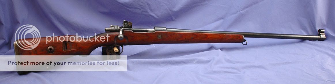

Finally finished her up today. This was a 98k that was converted to M59F1 specs in Norway. I have been told by Norwegian sources that all the parts to do these conversions could be bought directly from Kongsberg to convert 98k's for DFS matches as a factory Kongsberg M59 was an expensive rifle in those days.
It is a bnz 42 receiver with Kongsberg 27" heavy barrel in 7.62X51NATO and Busk diopter sight (graduated to 600m). The receiver, bolt body, trigger guard and floorplate are matching. The new barrel was numbered to the receiver when it was built. Nice bore in this rifle, can't wait to get her to the range.
I was able to source the stock set for it from Norway complete with front band and cleaning rod. I stripped the old chipped finish off with stripper and 0000 steel wool then finished it with several coats of tung oil, no sanding whatsoever. Turned out real nice. The barrel is free floating under the handguard. The stock is from a military M59 as it has the cutout for the side rail scope mount on its left side.
Not many of these around over here, on to the pics!

That is without a doubt one fine looking specimen you have there,well done!Very nice lines and configuration and it will be interesting to hear how she shoots,I'm betting pretty well.
looks very nice!! I normally don't like it when people change up military mausers but this one does look very nice. I really like the wood colour.
Thanks guys, I am trying to schedule a range day soon. I have some M118 to try in it and will handload for it in the near future.
Very cool. Where did you find this?
I bought the rifle on the EE from a fellow cgn'er. It had a bubba 98k stock and after some asking around on Norwegian forums, I found the proper stock set and made a deal for it.
Nifty build. Is the barrelled action an original M59 piece? I would have though thought it would have the milled flat o nthe receiver?
Factory Kongsbergs had the german markings scrubbed and were re-marked with their logo and "M59" on receiver. This particular rifle was a private build using Kongsberg parts on a customer supplied 98k rifle (more affordable option). Target rifles did not have the milled flat, only their military 98k's did.
