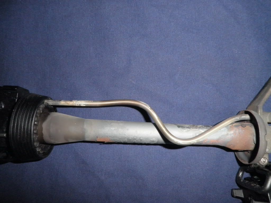

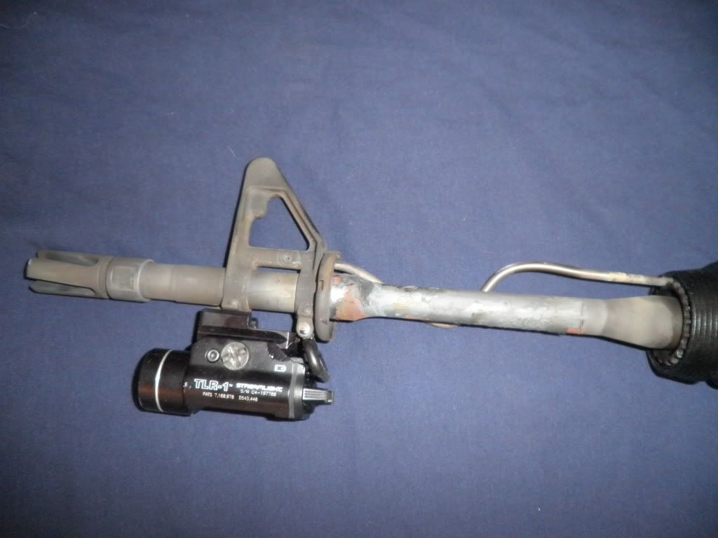

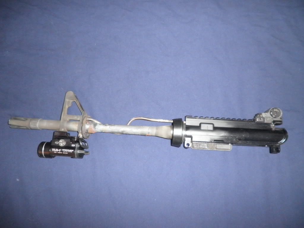

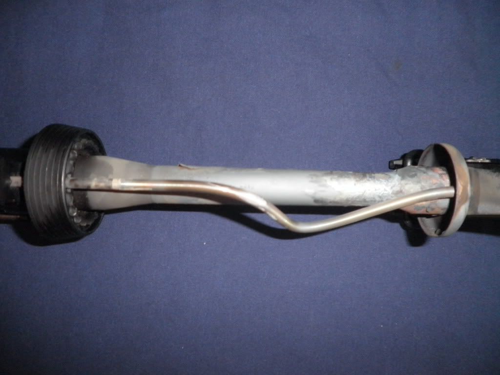

We 1,000 round torture test an AR15 SBR (short barreled rifle). Upper is an 11.5 inch manufactured by BCM with a Colt manufactured BCG. The lower is manufactured by Colt. I was lucky it did not have a major kaboom so I DO NOT recommend anyone try this. By the 24th mag the gas tube melted to the barrel. I had to manually extract rounds and charge the rifle. The hand guards were almost completely destroyed. I later found out the barrel was basically shot out. It would shoot lighter loads okay but heavier loads would keyhole. The whole rifle was extremely hot. The Aimpoint and Streamlight were very hot but no problems with either. I used various 30 round mags (USGI, PMAGS) and ammo (Federal M193, Prvi Partizan M193, Wolf 223 steel cased 55gr, Black Hills 223 remanufactured 75gr) for the test. I believe the rifle would have lasted longer if it had an aluminum rail system instead of the double heat shield hand guards. The hand guards just hold in too much heat.

Here's a 1000 round torture test of an AR15 (with his report below)
I guess as long as it doesnt affect function, it is gtg
