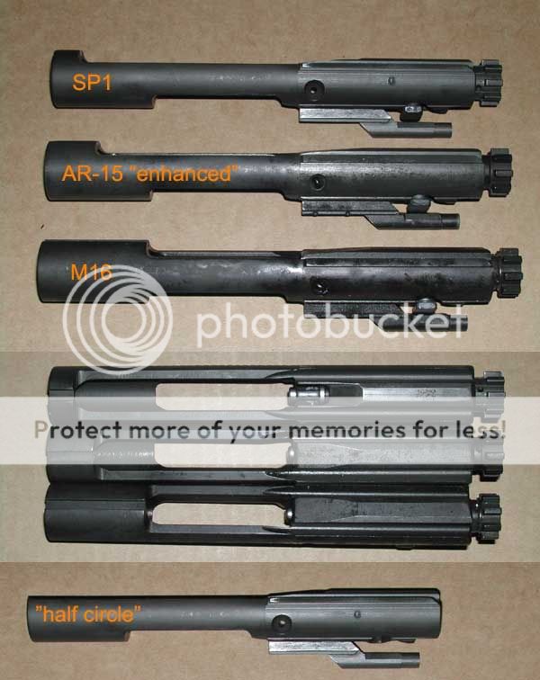

So can you please explain the difference of a full auto bolt from a semi auto bolt?
Semi auto have some less metal, some have a slot cut in the bottom, some are semi circle.
They all vary
They all vary
We're talking bolts not carriers! I'm unaware of any difference from a semi auto bolt to a full auto bolt. Some commercial manufacturers may use material different from carpenter 158 though other than that they have the same specs.
I would of thought because of the higher cyclic rate of select-fire rifle, that the material make-up of the bolt itself might be stronger or more hardened from that intended for solely semi-auto fire...
But I guess I assumed wrongly.
