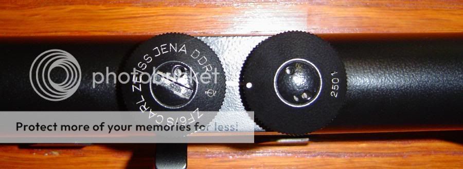

Noel: FWIW, you'll find two adjustment dials on the top of the scope. The one further forward adjusts elevation (remember that the reticle moves in these scopes). It also has what looks like a coin slot that allows you to lock the setting in place. The rear adjustment is your focus.
Windage is set by adjusting the four screws (two per side) on either side of the forward part of the rail. It looks like a pretty sturdy system. Also, the scope can be completely removed by simply unscrewing the two (claw) knobs that hold the base fixed to the receiver.

SillyMike, I've not seen the top of the scope yet, hope to by this weekend, they ship today! Yahoo!
That detailed info would be great to see, would you mind emailing it to me, or faxing, or something?
Noel
