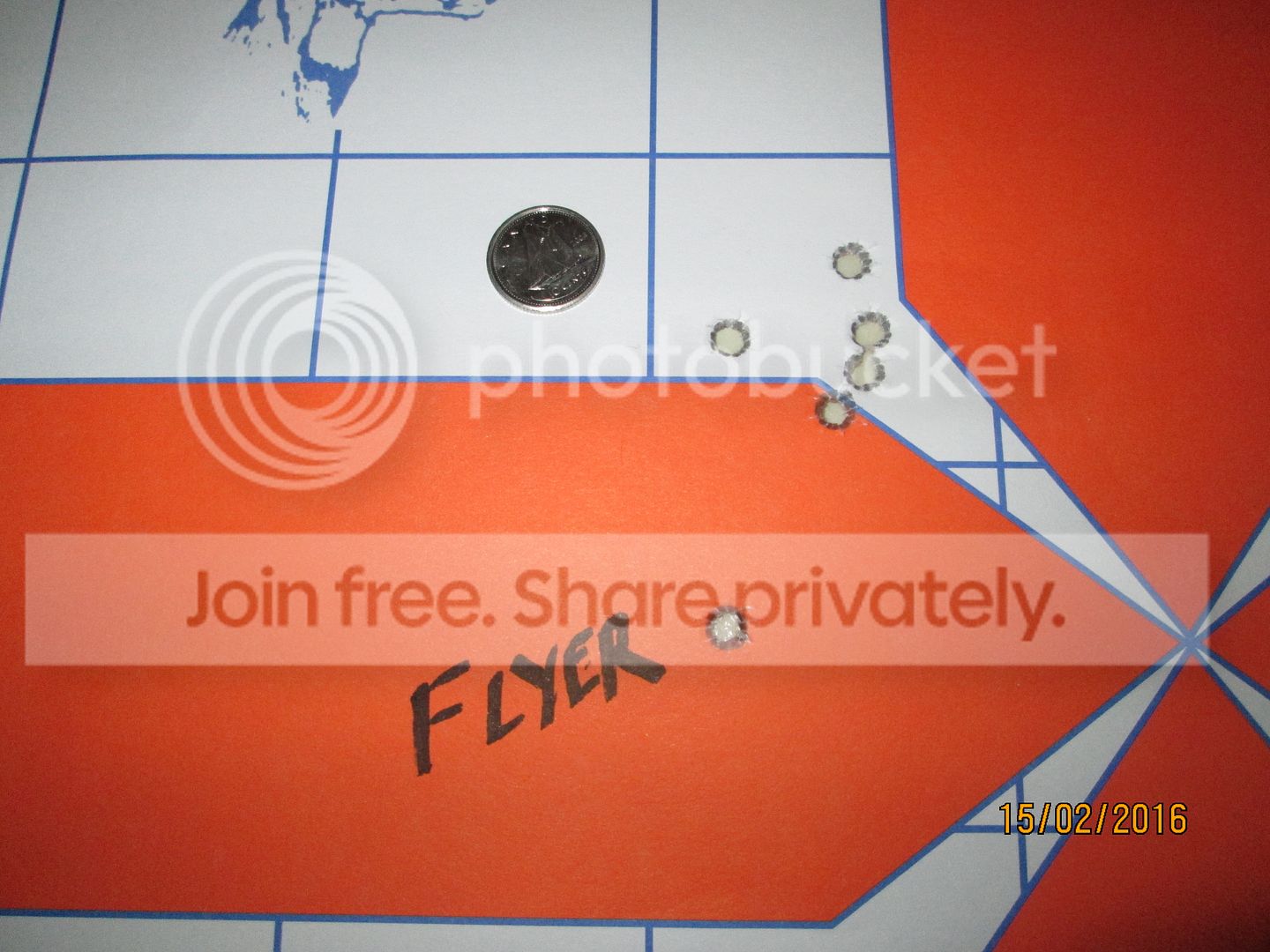

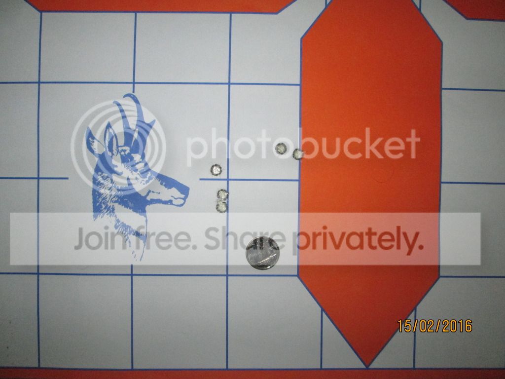

Ok, so today I went to the range with my 6.5x55 after the bedding job.
Shot 2 fouling shots (after doing the "wipeout" thing to clean the barrel) and then set up at 100 yrds. The ammo I used was Yugoslavian "Century" 139gr SP shells of unknown age.
The first 5 shot group was fired at 1 bullet about every 5 minutes to allow the barrel to cool. (It was about plus 3 to 4 Celsius out today, a beautiful sunny day to shoot.)

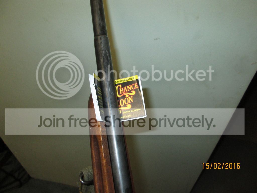

Seeing it was a fairly tight group but not what I expected, I tried the "business card between the barrel and forestock trick" and then shot 6 more rounds spacing them out time wise. 1 shot was a flyer so I didn't count it.
I will say I am glad I did the bedding job. I will do another small bedding job on the fore end to tighten the barrel further.
