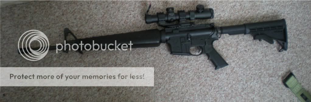

I have recently, purchased a Leatherwood Hi-lux and have been shooting it bit, finally have it adjusted right on my rifle and getting the hang of it and figuring out how to dial it in.
So far I really like it. It has a illuminated Reticle, and magnification is 1-4x
$399 from wolverine supplies so it was in my price range, all other scopes I saw were running$599-800 even $1200 so it is affordable.
