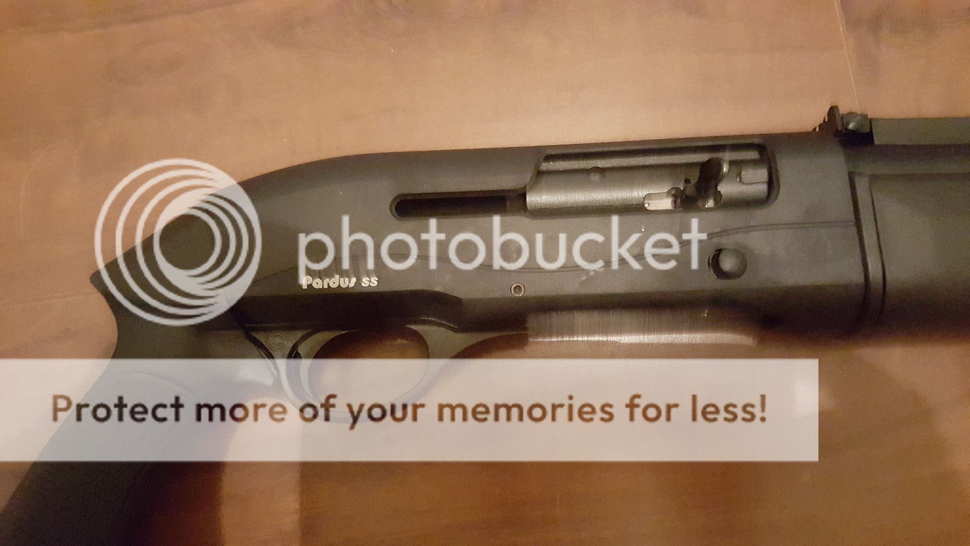

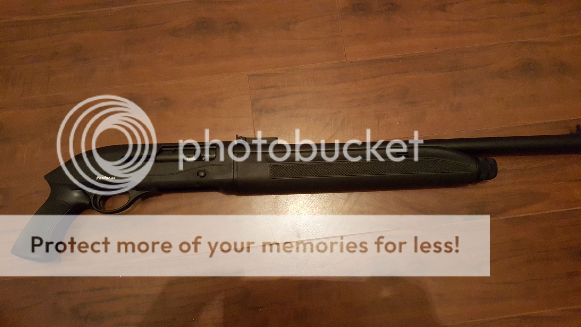

The long and short of the Pardus SL:
-Comes with removable chokes in a nice little choke case with wrench. Modified, Full, and Improved Cylinder. Uses Beretta MobilChoke style chokes like most other Turkish guns arriving.
-Very light, with little weight up front. Gas piston around the magazine tube, recoil spring in the stock.
-Shell lifter is half closed in normal use, so I don't think it will ghost load (but will try when I'm at the range)
-Does NOT come with an extended magazine tube, despite the product image that is on the WSS product page.
-Stock is plasticy, hollow sounding. Buttpad has some give, but is not super squishy.
-Decently polished chamber
-Magazine tube uses same thread pitch as Benelli Super Nova/Stoeger 3500, but is crimped at the end. You'd need to remove the crimp to add a magazine extension.
I'll have a more complete review on my site and YouTube channel after I've got a chance to run some rounds through it. All in all, seems like a stupid good deal at $260.
