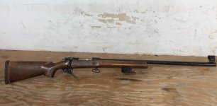

You have a very solid foundation for a C3 build. Is this single shot? and did you take out of the stock to check date code? Send me a picture of what you see - It may be the correct C3 build date which would be awesome!
Hi Ron, the rifle is single shot but the stock has a cut out where a loose magazine spring and follower sit and it allows for a single cartridge to be inserted onto the follower. I'm not sure if that is just how they came or not. The date code on the barrel is ZB, 3. From a quick search I did that indicates 1974? Would love to hear your thoughts.
