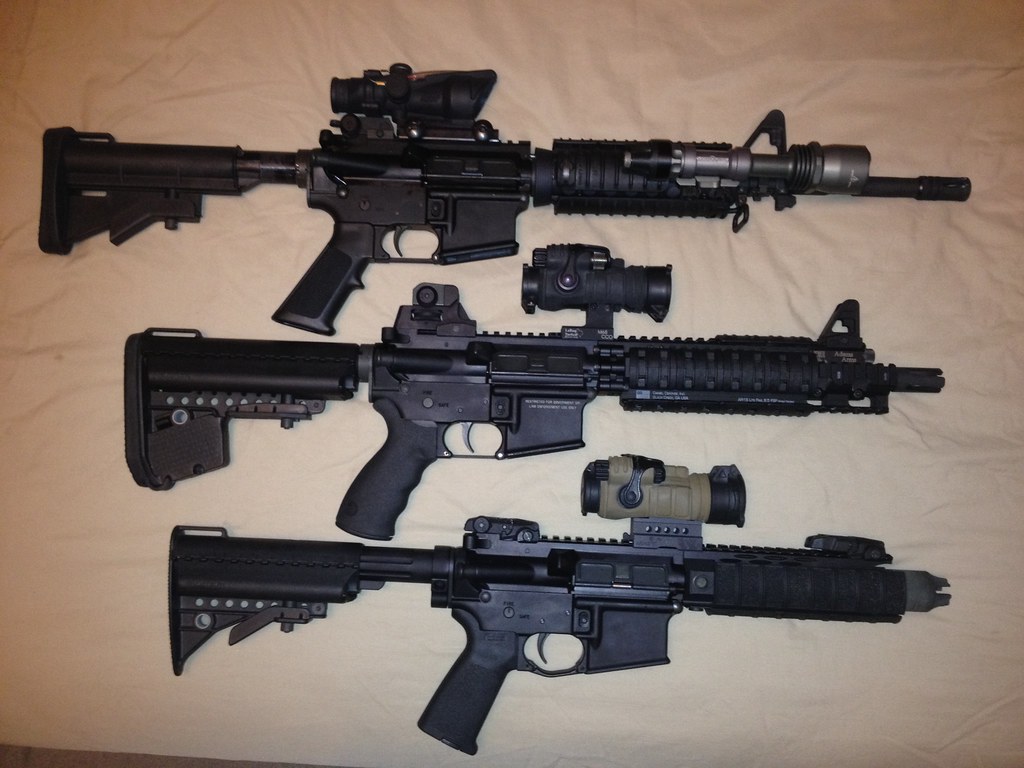

Just thought i'd share.
Middle AR: Built...runs like a sewing machine
10.3" Barrel take off from N8 CQB
Stag Upper + BCG
Adams Arms Short Stroke Piston Conversion
LMT Defender 2000 LE Marked Lower
LMT 2-stage trigger
LMT Front and Rear Fixed irons
Daniel Defense FSP AR15 Lite Rail 9.5"
Dlask 'Vortex' Flash Hider
BCM Gunfighter Mod4 Charging Handle
VLTOR E-Mod Stock
Ergo Grip
Aimpoint CompM3 + Larue LT-150 Mount
Bottom AR: Bought...just wanted to share
PWS MK107 with VLTOR Mod Stock and Aimpoint CompM2 + Arms Mount
Top: Not anywhere near a PDW. Just my attempt for 14.5" USGI M4A1 Clone - Sabre Defense XR-15 with TA31RCO-M150 Trijicon ACOG

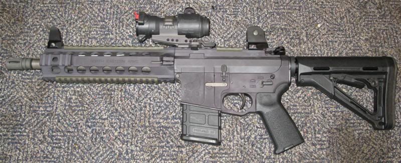

Your 300 Whisper is purdier. Looking forward to seeing what NEA is coming out with in the future. If it looks like your current build, sign me up!
I am interested to see what they have come up with as well. They keep telling me they have improved it but honestly how do you improve upon perfection? :)
I am really liking the shorties these days. I have an 11.5" that I never shoot. Even the PDW Whisper gets the nod more often than its 10" cousin. The little guns with big HP are just more fun.
Now if I can figure out the 6x38 PDW round I have been working on, that will be a nice combination of ballistics in a small package.
