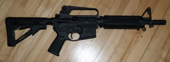

After a lovely Christmas gift from my kids, a CTR with milspec tube, buffer and spring, and the addition of a Vortex flash suppressor - TADA
Cute - what is the base rifle/A2 upper?
Cute? Ugh lol.
The receiver is all Bushmaster XM15-E2S with the MOE grip and trigger guard and CTR stock with four position receiver extension. The A2 upper is Armalite with a Bushmaster heavy barrel. It's the same rifle I had up earlier in the thread with the new stock and Vortex addition.
With the old stock (ACE skeleton) she shot 9" pie plate 10rd (LAR mag) "groups" as fast as I could pull the trigger on a Fig 11 at 50 yds.
The next time I get out I'll try to "bench" the rifle and shoot some groups at 50, 100 and 150 yds.
