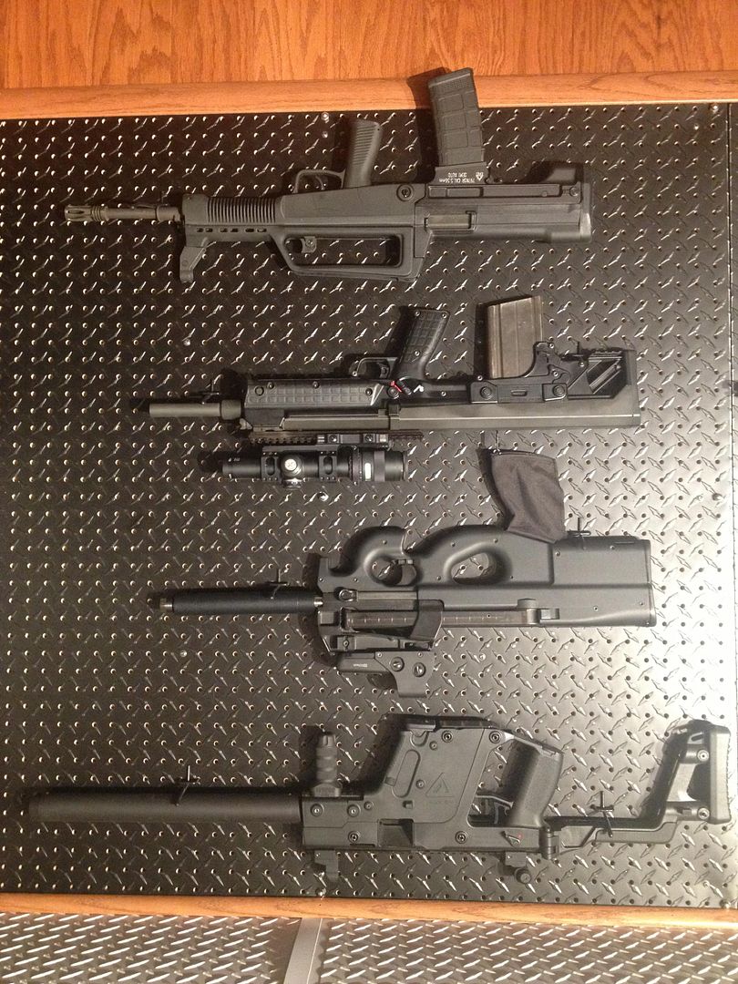

PDW builds - Lets see them, and share results
Psh, you guys and your "AR-15 style firearms"
Back on topic with PDWs!!
Mirror finish magazine? First time I seem in my life. Nice

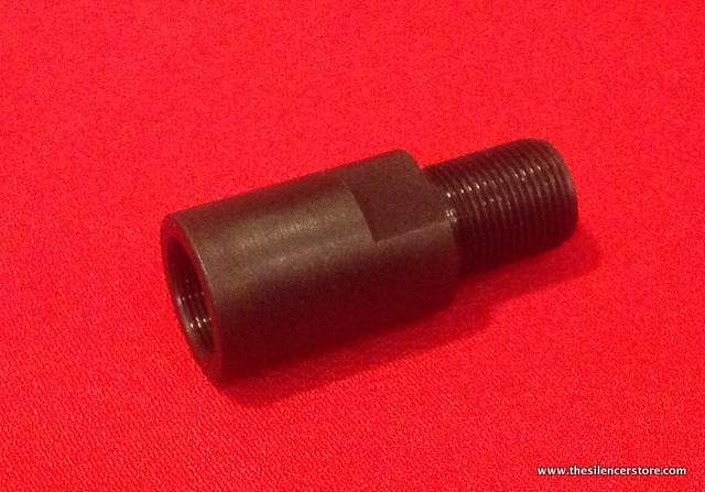

No because it won't work. You can't retap 28 tip thread to 36 tip thread of the same size without buggering up both. The only solution is to cut off the existing muzzle thread and recut new 1/2-28 thread along with a new crown. Either that or have a conversion sleeve/extension made.
EXCELLENT Idea ! I scoured the internets and found:
Its a 1/2x36 to 1/2x28 Thread Adapter - its $49.99 SO Im going to give these guys a shout to see if they are OK with mailing this to Toronto.
