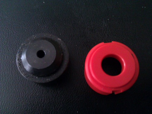

I have a black metal follower like the one in this picture...
I'm thinking I could enlarge the hole, and use a nut and bolt combo, with red loctite or epoxy to keep it on there perminantly. This would be preferable to messing with the magtube, I think...
Edit:
I put together a solution that works perfect. Make a dummy 2.75 in shell. Fill with birdshot or buckshot to give the shell some structure (so it won't collapse).
The shot side (as opposed to the primer side) of the shell will fit directly into the muzzle side of the OEM black Mossberg follower. Drill out the primer cup of the 2.75" shell and get a long bolt and nut to run all the way thorough the dummy and the hole in the follower. Then use the nut and some loctite or epoxy to permanently fasten them together.
with this method, you can fit 5 3" shells in the tube, and you can insert about 80% of the last 3". You can comfortably get 6 2.75" shells in the tube. By comfortably I mean the spring wont bind up and the shell release springs will still work (which I find they won't if you're really squeezing that last shell in)....
I believe this would qualify as a permanent modification to the follower.
Used the stock spring as the S&J supplied one was a little too stiff for this purpose...
