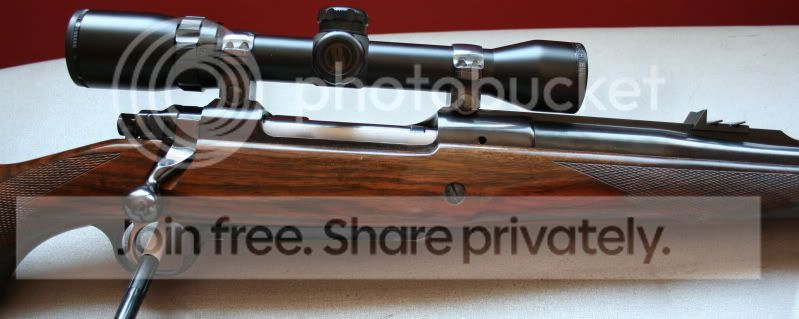

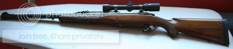

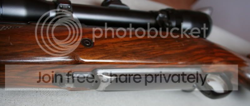

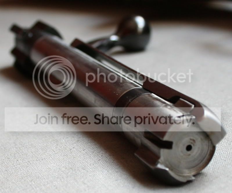

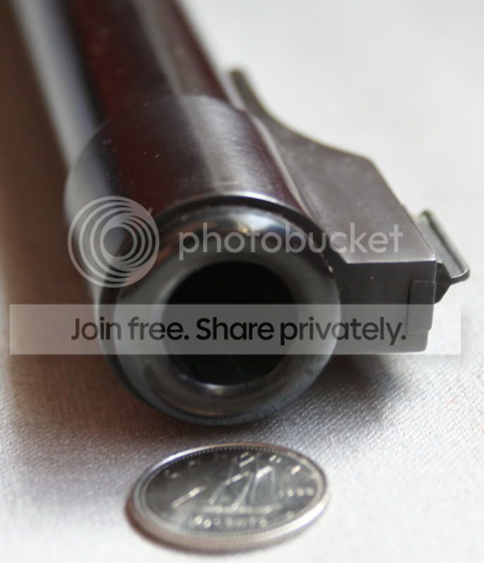

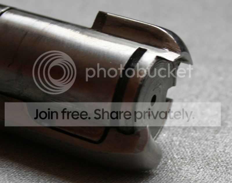

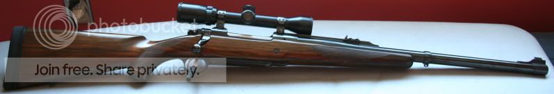

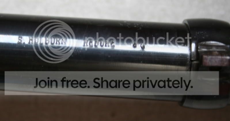

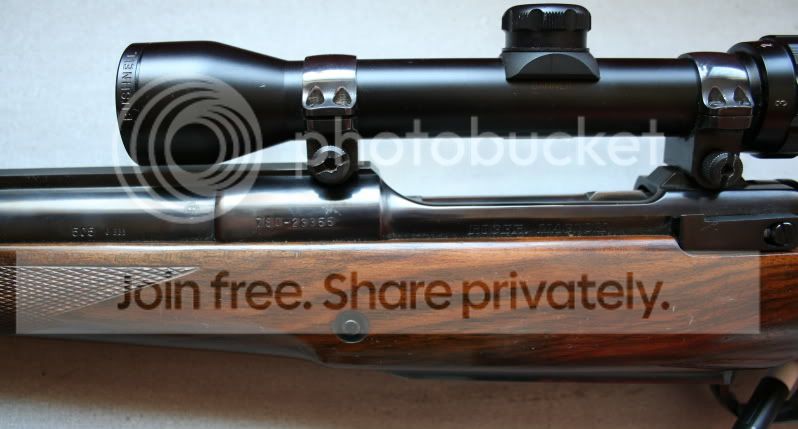

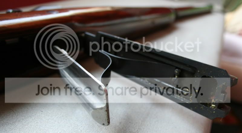

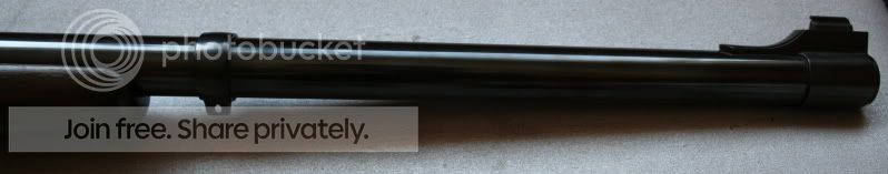

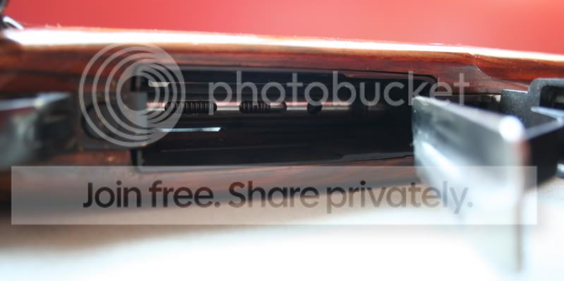

I recently picked up a Ruger RSM that had been rebored to 505 Gibbs by Steve Holborn of Warren, ON in 2004. In addition to reboring and rechambering the barrel, the bolt face was opened up for the larger case head and the floorplate was extended to allow an extra round. I'm unsure if anything else was altered on the rifle aside from the addition of a Decelerator recoil pad. I'm planning to write Steve and see if he still as the original work report.
The rifle shoulders and points very nicely with the large diameter 23" barrel.
Although I wasn't looking for a big bore rifle, and have no plans to hunt Africa, the rifle was so unique and well-made that I had to have it. I'm still sourcing reloading components, but my plan is to load some light cast lead rounds and start working up slowly to get a feel for the recoil.
I thought some of you might be interested in seeing detailed pictures of the alterations. My apologies for the scope and any dirt/brass shavings on the rifle; I haven't had a chance to remove the scope or give the rifle a good cleaning since I bought it.

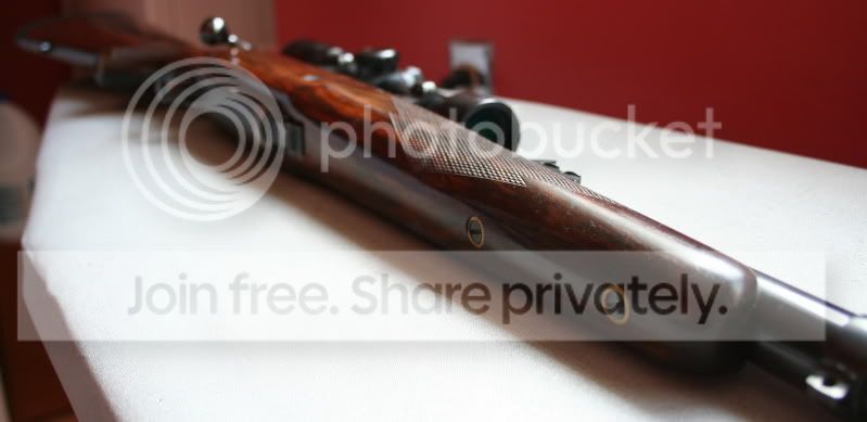

The bluing wear on the action suggests some honest use. I wonder what nasty beasts this has taken down? The floorplate suggests scabbard use. I like the extension on the floorplate, its very nicely done. So this gun holds 3 down now? And how much does it weigh? The end of the barrel shows it could have been bored even larger with no worries.

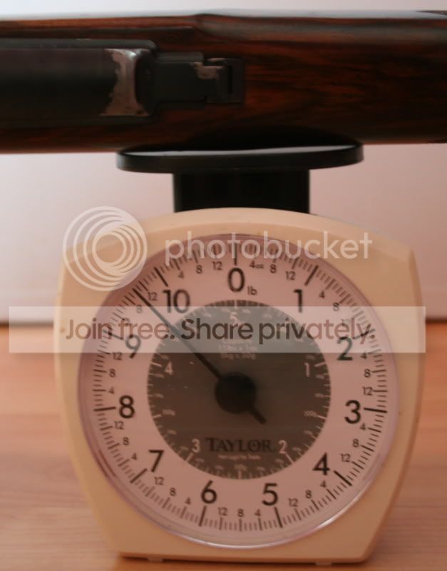

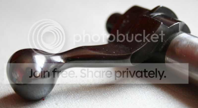

Here are a couple more pictures now that the scope has been removed. I was impressed by how seemless Ruger carried the quarter rib through to the receiver. Unscoped and unloaded, the rifle weighs approximately 9lbs 10oz. Although I don't have brass handy, judging from the size of the bolt, I think the floorplate extension will allow 3 rounds staggered plus one in the chamber.

OUCH. Under 10lbs will set you back. Make sure you have a good recoil pad on that beast. I have used Trailboss in my 510 with some woodleigh 450's. Recoil was non existant. I went with 75% volume then rounded up to the next even grain. That powder is very light for volume so it seems weird to put 38gr in the case when it usually takes 110. If I cast then I would try this for sure.
The 1/4 rib looks seamless because it is - it is machined from one piece. One of the reasons they likely stopped making this model Cost.
