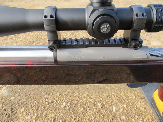

And After: All painted and dipped by LiquidCustoms.ca. I did the stock prep work and he applied the paint. More pics in post #41
The machining for the Barreled Action and Cerakote was done by Terry at Black Art Rifle. Superb work and this rifle is shooting very well.
BEFORE:
Update: Stock work pretty much all done. Now to seal, paint and add some colour to the barreled action. Bolt has smoothed up very nicely and runs slick. I have shot the rifle and it is going to be an accurate shooter.
Ejection of the cases are a little too energetic. Great for a hunting rifle but not so much for FTR... Try and chop the spring or just remove the ejector.
Project will get finished for spring 2015

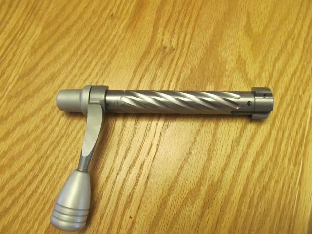

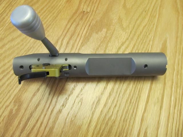

I am thrilled to have received my new Pierce Custom Titanium Rem SA type receiver. This will go into my new FTR rifle for the 2015 Season.

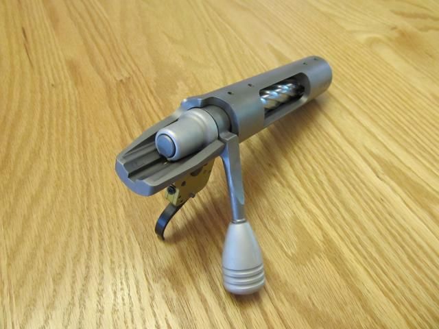

Long Tenon, Fluted Bolt, Timney Calvin Elite - Action is in the White.
Rear Square Tang

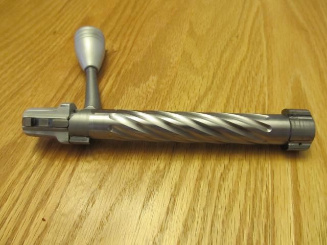

Fluted Bolt Body, Tactical Bolt knob, Cone Breech
Beautiful machining and chambering by Black Art Rifle Company. Min spec chamber and will be throated for the 30cal Heavies

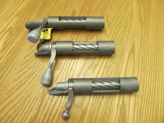

Some other Pierce Custom Receivers - Repeaters with 308 and 223 bolt face
Very impressed with the machining and tolerances of these Actions. I have seen them in action and they work very well. Can't wait to get my rifle finished in the coming months.
Weight of my receiver without base or lug as pictured... 23.5 ozs
Pierce alloy base is about 1 oz

What is the true weight of the single shot action with the trigger and rail? Are you using a recoil lug for the action?
Jerry great info nice to see photos of the action setup. This is just killing me....decisions decisions.
The weight as pictured is 23.5ozs Rail should be 1oz.
I will be using a steel recoil lug (1oz) with the action although, with the square tang, you don't need to.
Given the very high number of rds that will be fired, the lug will help stop any wear and tear on the stock.

For weight comparison: no rail, no lug, no trigger
Titanium single shot SA with extra lightening, standard profile and tenon, tactical bolt knob - 20.8oz
Titanium Repeater LA, standard bolt knob (small knob in the bottom action in the pic of three) - 20.5oz

The square tang will help with both torque and recoil control. the flat in the receiver will also do some work BUT, this rifle is going to see thousands of rds per year. That type of pounding is going to wear on any stock so adding a larger recoil lug from the beginning will be a good thing.

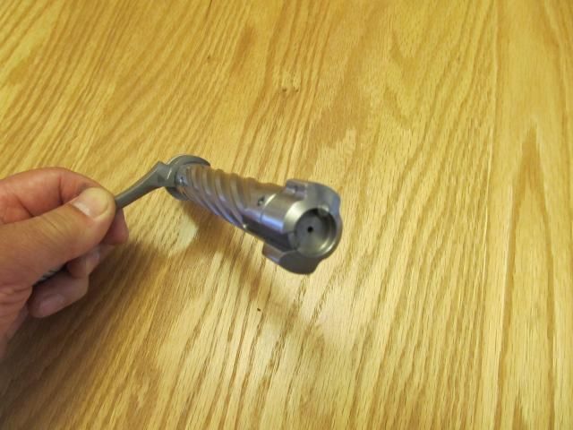

What is the bolt made of... Titanium or steel? How big is the firing pin hole? .062, or larger like a standard Remington? No ejector.
NormB
Bolt are 1pc steel... no similar metals issues. Very nicely made and fit is excellent.
Small firing pin with tight tolerance... no bushing should be required.
All actions we ordered had ejectors but that can be easily removed.
Ejection has been very good, flinging the case in a nice arc out of the action.
Jerry
