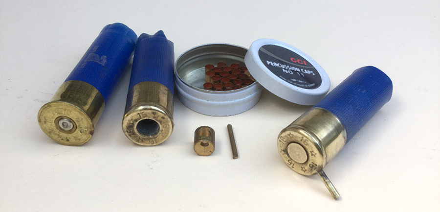

From what I've read thus far, the brass kit are the "easy" way to do... at about $20/shell (+ tax and shipping)
Or making your own by swaging fired brass hulls, then making a piece to hold the percussion cap/primer...
- But while everyone talks about the swaging, no one ever mentions where they got the dies/tools?
Interesting that the primer is replaced by a cap holder. Makes it easier to set the cap in position. Original pinfire primers are slender things, and were positioned with a specialized tool. The pin was drawn out a bit, the primer was positioned, and the pin pressed back into place.
From the look of those repurposed plastic 16ga shells, was the case pushed rim first into a die, or was a rolling technique used?
I have a cheapie Belgian pinfire that I have been putting off trying. But have thought of using a simpler method since mine has a rim recess. Drill a hole for the pin at the correct angle through a fired hull then use the hole on the opposite side as a starting point to drill a hole for a #11 percussion cap. Main reason I haven’t don’t it is the gun stock is in bad shape and it was a 14ga reamed out for 12ga hulls.
In the OP's post, there are 16ga plastic shells which have been reworked to alter the rim. Pinfire shells don't necessarily have a rim the way centerfire shells do. I'm assuming the shells were passed through a die which pressed the rims inward. Whatever is being adapted has to be able to chamber freely.
I have used the commercial brass pinfire 16ga shells. Had to shorten them on the lathe to suit my gun's chambers. Problem with them is the expense - I only have half a dozen of them. Altering readily available shells is appealing. Easy enough to make up the little cap adapters.

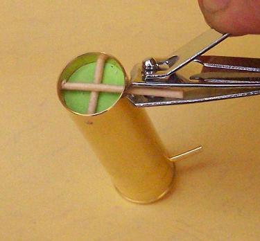

I have found that a thin dowel (or a chopstick), tipped with something sticky, works extremely well for placing the percussion cap in its socket and lining it up, before inserting the pin to hold it in place. Back in the 1860s, a frequent cause of misfires was that the primed cases, purchased ready for loading, occasionally lacked a cap altogether -- you just can't depend on child labour, I guess.
